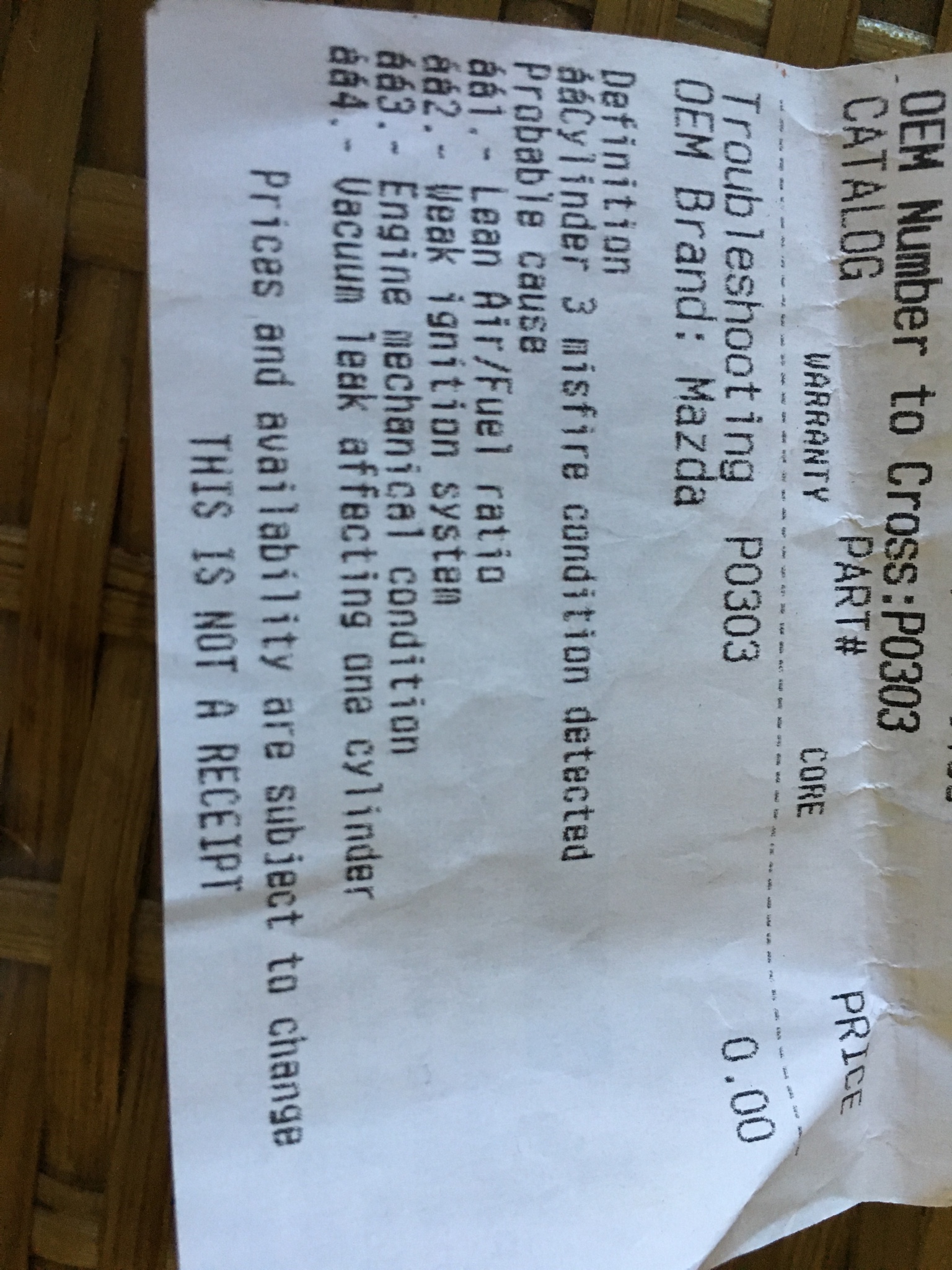

So I went to grocery shopping yesterday and while coming back, it started vibrating and lost power. Check Engine light, TCS, and TPMS lights came on. Nearest mazda dealer is 50 miles away, so went to autozone and got the codes checked and they said, ignition coil #3 is misfiring and need a replacement. I ordered one with them and will get it changed sometime today.

I changed the spark plugs at around 80k. Auto zone ran the code through their system and it said ignition coil #3. Since the nearest Mazda dealer is 50-60 miles away, my cheapest option seems ti be get it drivable (by getting after market) so that i can at least reach the dealer and get the complete diagnostic.

Interestingly the report from AutoZone listed several causes for code "P0303", but only "Weak ignition system" indicates something related to ignition system which may be failing but it doesn't specifically say it's ignition coil. I wonder how did AutoZone figure out it's ignition coil? May be they have seen this problem many times before?
I am not exactly sure how they pinned it down to ignition coil but they were very sure about it.
