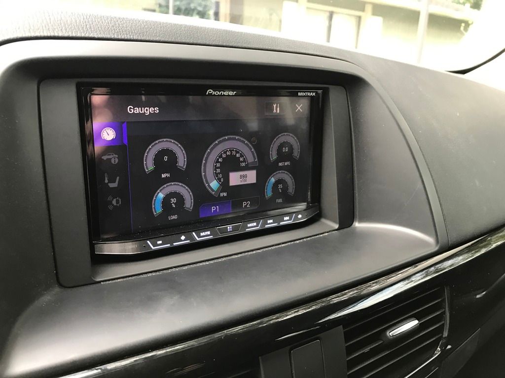

I just bought both for my 2015 touring, but have not yet installed it... The MaestroRR does need to be flashed in order to work with the CX-5... I think it's worth it just for the gauges... hoping it will do the lights as well, but not certain.... Maestro Tech support is awesome!
Well, I went with the iDatalink and I'm glad I did. It was only a little more expensive then the standard steering wheel control module. It does all kinds of things but the big advantages are being able to assign two functions to the steering wheel buttons (short or long push) and of course to see all kinds of "gauges." I know it's trivia, but I like having access to the actual coolant temperature rather then just a little blue light. Of course I'm a pilot for a living and a nerd for a hobby so staring at gauges is something I like to do. It may not be for everyone...

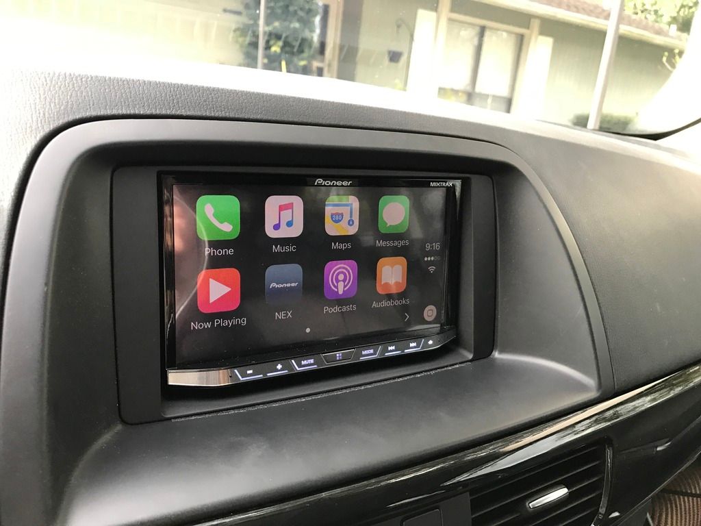

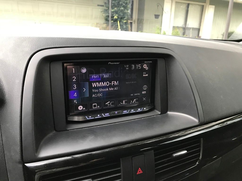

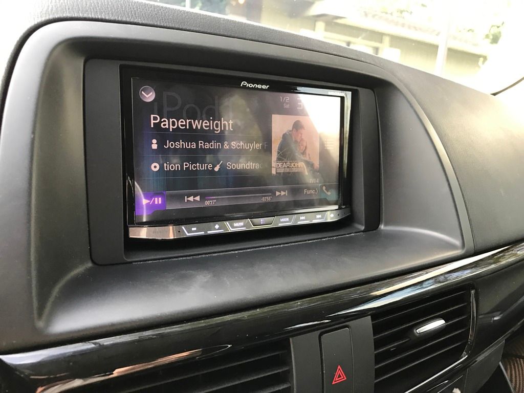

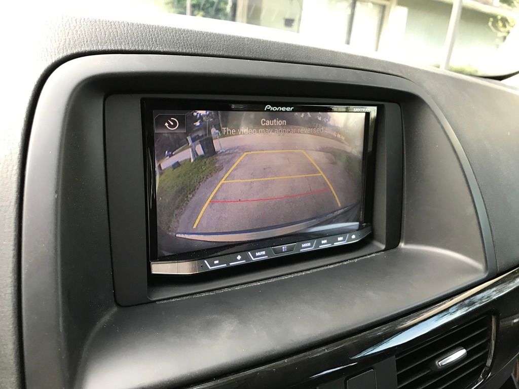

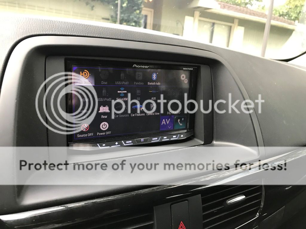

UPDATE:
Here are images of Mine with the Maestro installed...
Note, Head unit replaced, the sound quality is exponentially better, Speakers have not been changed yet, Amps not yet installed... Note#2 working with Maestro to get the "Voice/Siri" button working correctly, it turns out that you cannot map the 2nd button mapping on the voice button on Pioneer head units (Per Idatalink)... The Maestro system also allows programming of secondary functions on each button....

did you do the 6v step down to make the backup cam work?

I purchased the Metra harnesses and 6v step down from Amazon, and also received them from Sonic Electronix with my stereo.
