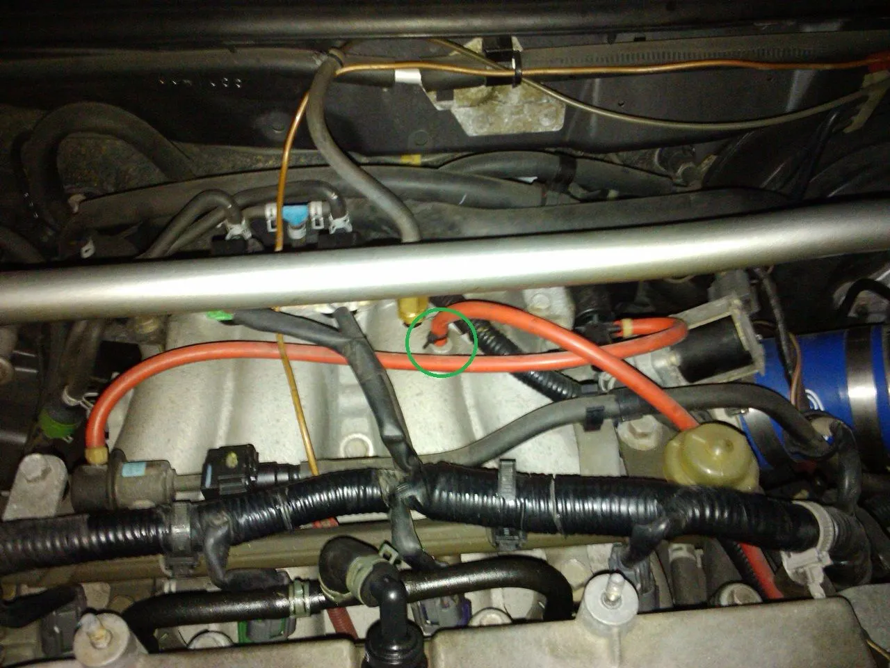

One more question about this setup. Is it ok the get the vacuum signal from after the throttle body for both the WGA and BOV? Here is a picture of where the BOV and WGA are connected, they are hooked into a T from 1 line. Wouldn't it be better for the WGA to be connected before the throttle body? If so, how do you do it?
I run a dedicated line from the brake booster line to the BPV (BOV for you). The wastegate actuator line comes off my manifold.
