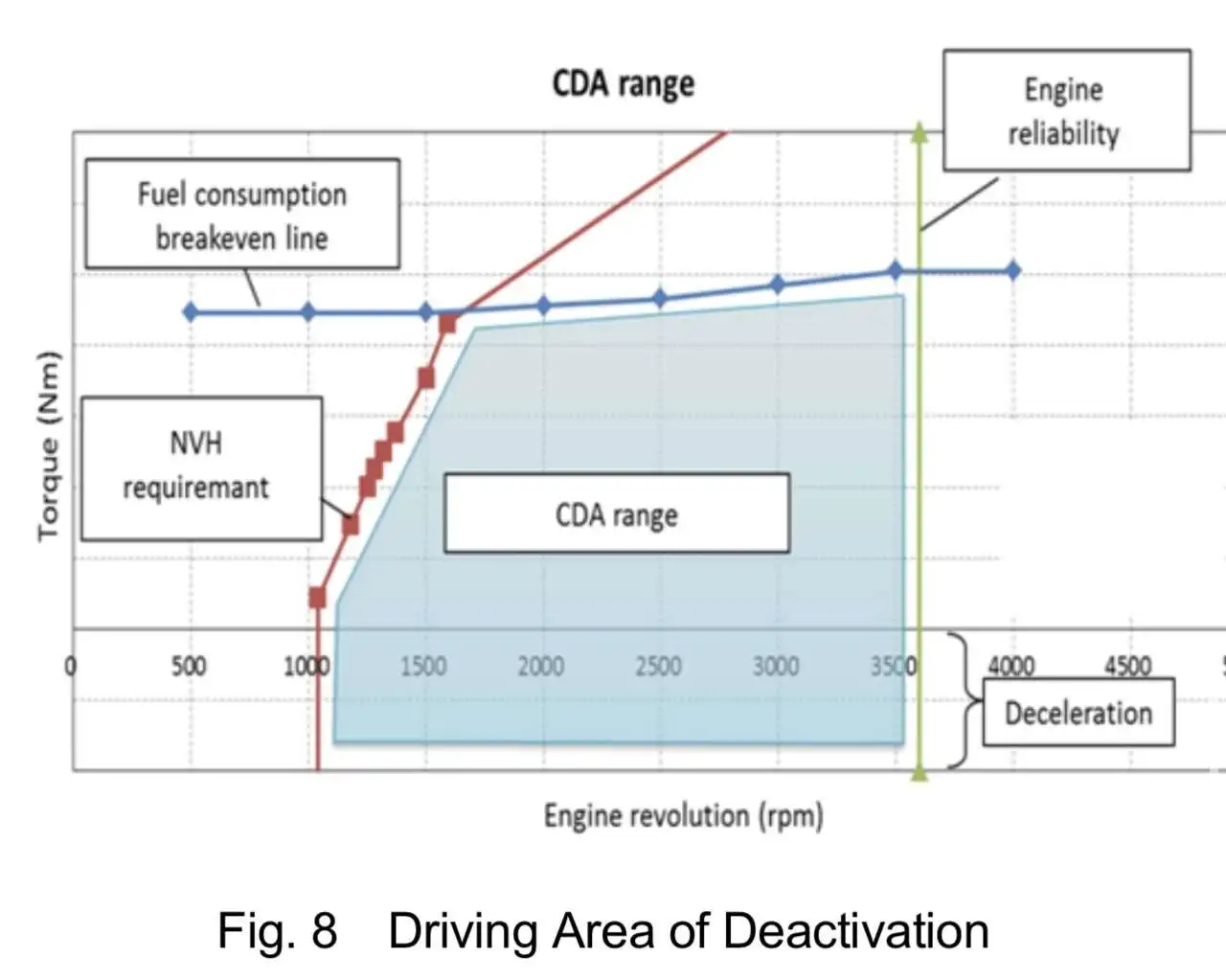

torque and rpm are the leading factors. CD can trigger at any rpm in the range.
speed is not relevant.
unless you have the monitor app in the infotainment (2020+ models) or OBDii tool, watching the fuel cinsumption is not very good indicator.
here is the cd range below

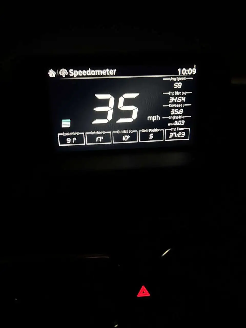

This is what I get almost always when driving within the speed limits - 35.8 for this trip
There are no units on the torque axis. Did those get cut off?

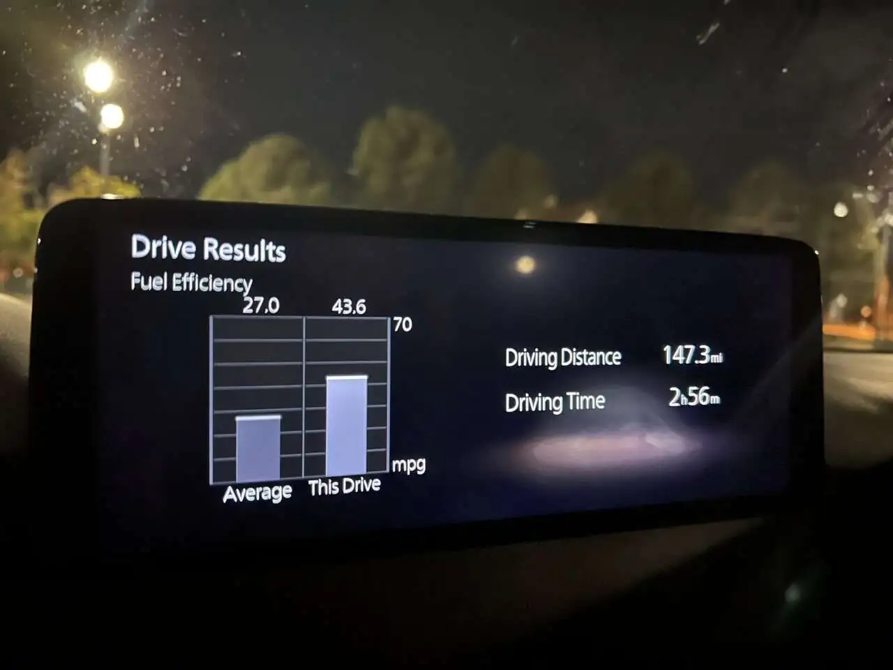

On a route where I could coast a lot yesterday my readout summarized it to be 43.6mpg, wow. I watched the CD screen part of the time and it only deactivated when I barely asked any power from it (55-70mph)

On a route where I could coast a lot yesterday....
As an FYI, if you are not already aware, when coasting (foot all the way off the gas), the cylinder deactivation display should show no cylinders operating. That's typical of modern fuel injected engines and not an aspect of the Mazda cylinder deactivation we're discussing here.
