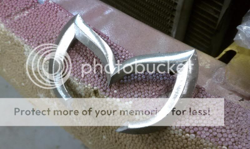

Custom brushed evil-M :D

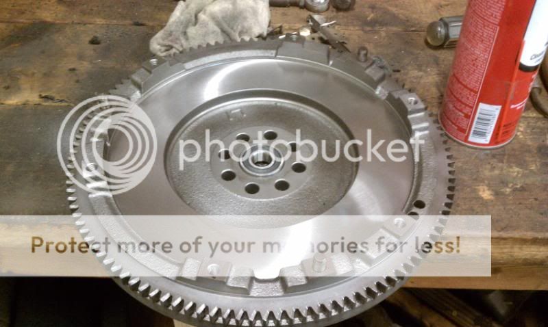

Refinished Flywheel:

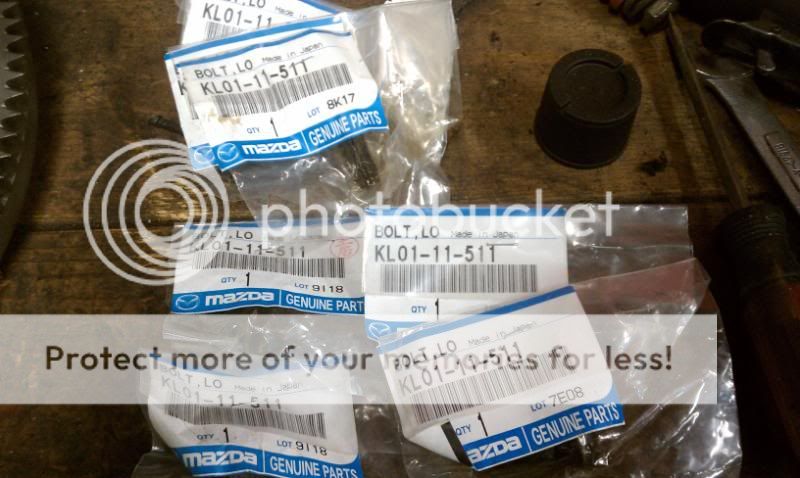

$32 worth of flywheel bolts...sigh...

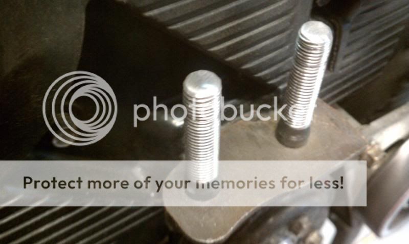

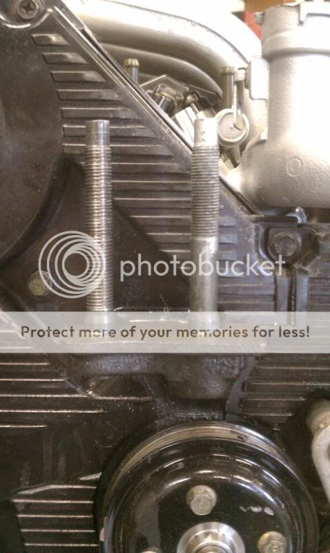

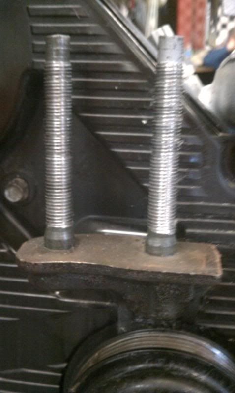

I don't need no stinkin' protege studs! FS protege's are tough to find around here, and given I didn't get the FS with my P5 i got crafty. The pitch is M12x1.25 so I found a die and got to it. I did both studs then measured the studs on my dad's MSP to get the proper length.

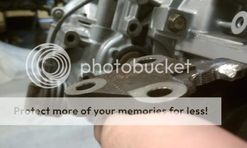

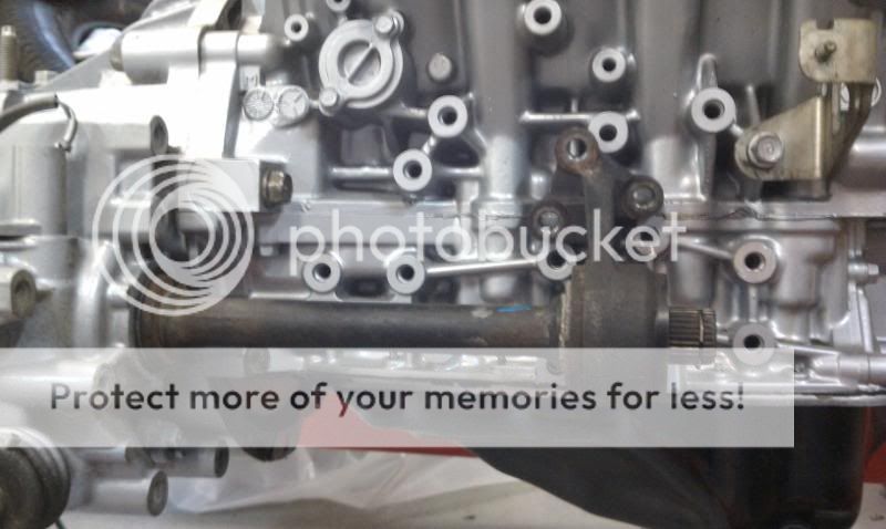

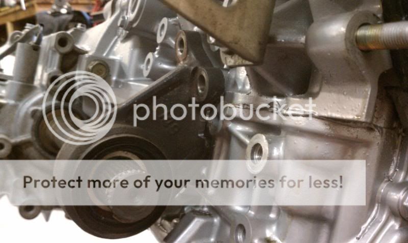

Next is my current hurdle, I picked up the correct 626/mx-6 bracket that everyone references and it fit before I put on the transmission, but now that the trans is in place, I can't rotate the bracket into place to line up with the holes. When I got the motor it had the two bolt flange, but the mx-6 folks were pretty certain that 3 bolt flange is what is required for the ZE. I'm thinking about pulling a 2 bolt flange off of a later model KL to see if that works, if not, than I may be cutting it up and welding it to fit. Not sure what you other guys are doing for half-shafts, I know Justin customized his own halfshaft. I did take it to the machine shop to take off about 2mm of the flange but that wasn't nearly enough.
Wow that is messed up. I was always told the 3 bolt flange would work perfect with the ZE. the two bolt will not line up with anything once in the transmission. It really makes me wonder what shaft the ZE is ment to use.
Hence my confusion. This is what everyone says they use, but I wonder if something with the blocks changed when they changed the shafts. Hence, I'm thinking about grabbing a 2bolt KLDE flange from a later 626. Worst cash I'll be fabricating like you did, what did you start with, your FS halfshaft?
I had the FP before the v6 so it had an f-series trans which the shaft wouldnt work with the v6 gseries. So i bought a two bolt later model mx6/626 shaft. None of the the bolt holes ont he 2 bolt lined up with any of the holes on the block. So We cut the 2 bolt flange off and made one with three holes that lined up with the block
what i did with mine was much easier then what justin did. the half shaft i bought had 2 holes but also had a spot that looked like it was meant to have a third hole but it just didnt get drilled out. i drilled out the third hole and then elongated another hole that was off by a hair. and that was it. unfortunatley i dont have any pics but i can get most likely get some tommorow but if i cant then i will get them mon cuz i have off of school and work then. and i will try to find out what halfshaft i bought
See that's where my confusion lies, everyone always says that the problem is that the holes don't line up, but I can't find a single post that talks about the issue I'm having. I think next weekend I'll get by the junkyard and pull a halfshaft from a newer (96+) 626 and see what shakes. perhaps something changed with the blocks on the curve neck ZE's? The halfshaft I picked up was out of a 93 probe, which shouldn't make a difference as it looks identical to every other one I've seen.
I think I can follow what you did by your description, but any pictures would be great. I could always remove more material from the flange, but I don't want to risk the strength of the part.

It cost me $50 to have the machine shop take ~2mm off so I'm not sure if I want to keep paying them so that I can take a little off at a time, then my concern is the strength of the bracket after all is said and done. I'll research a little more tonight and see what shakes.
why dont you ask the machine shop to do an angle cut like this. i feel it would do more to make it fit then just traking material off the face
