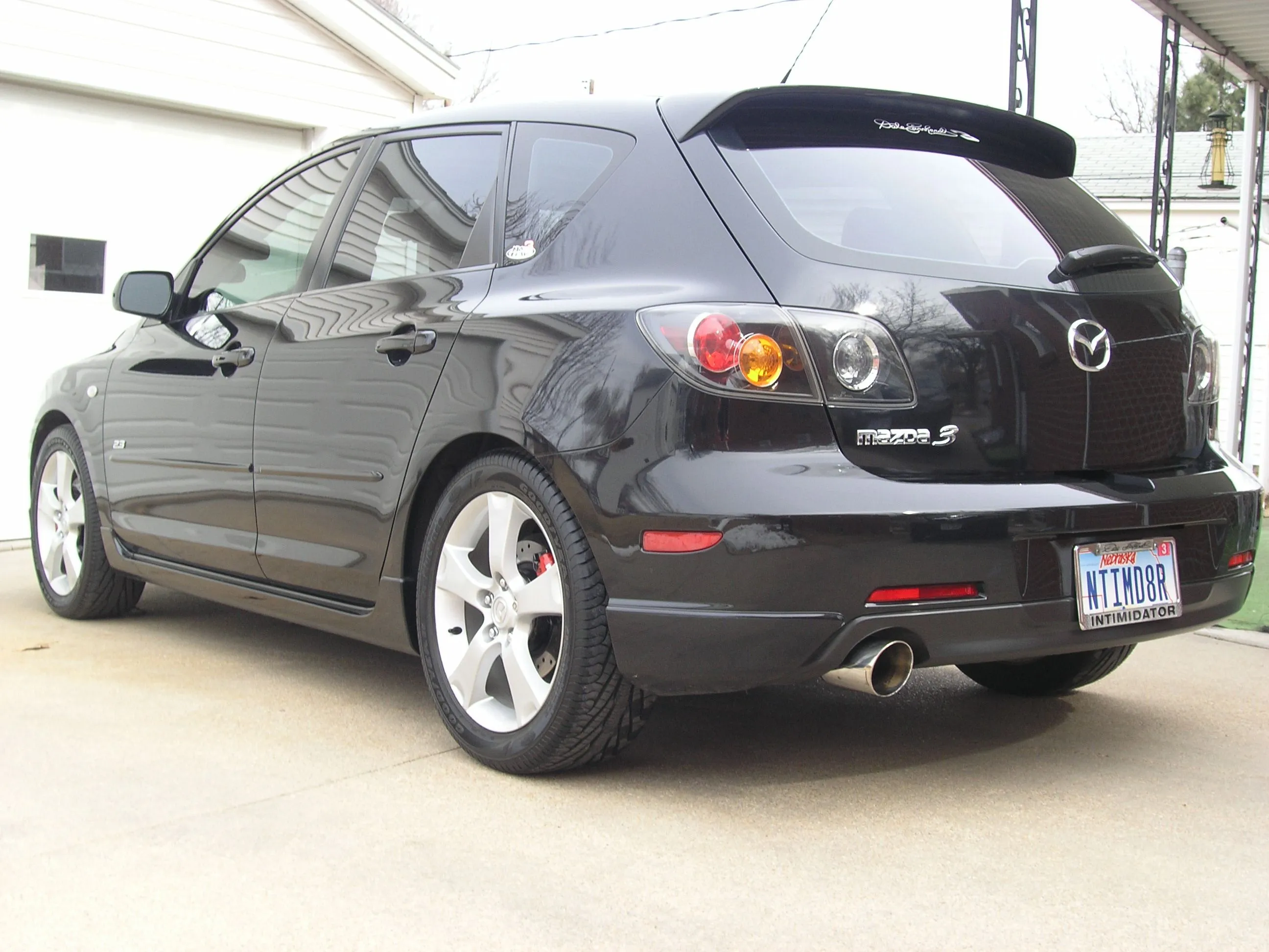

The 3 has a little more rear negative camber (top of wheels leaning in toward the middle of the car) than most cars. That's one reason why it handles so well! The down side to this is that if the tires aren't rotated regularly, "cupping" occurs along the inside of the rear tires. By looking at your current mileage and the mileage you bought it with, if you haven't rotated your tires then I'm guessing that is what your "flat spot" problem is.
Check out the below picture. If the wear on your tires looks like that (notice the dark then light areas along the inside of the rear tire), then rotate your tires and get a 4-wheel alignment.
