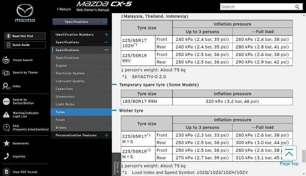

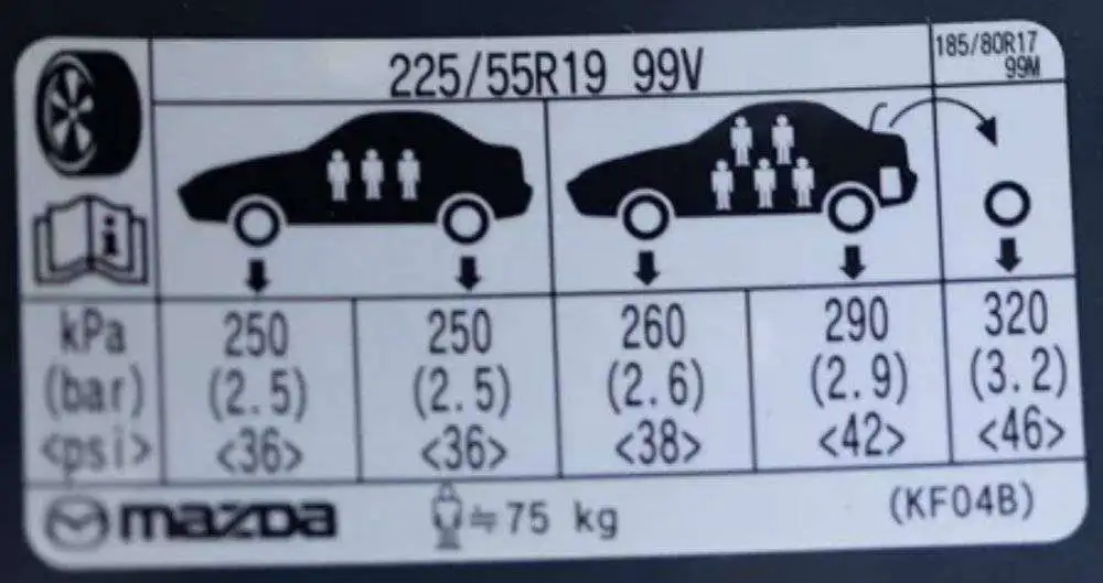

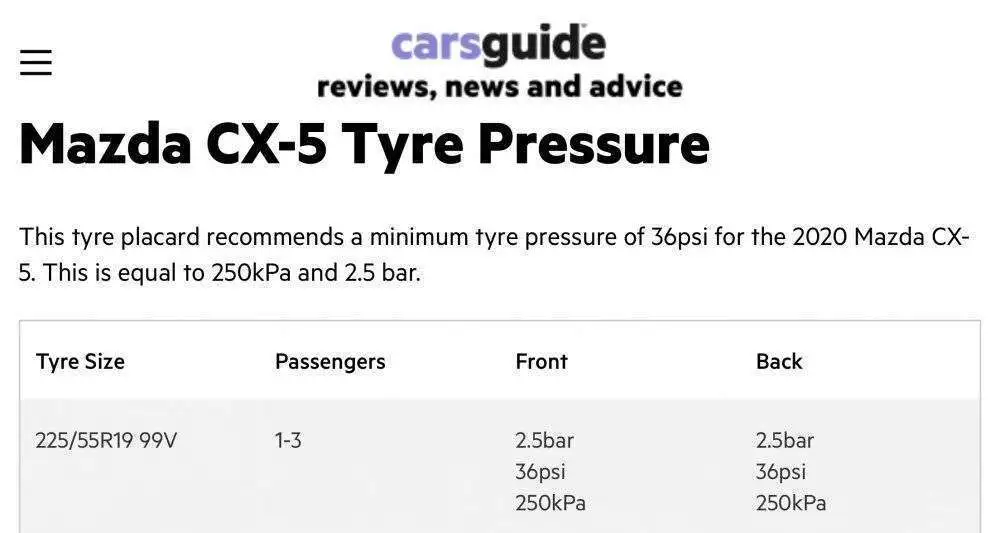

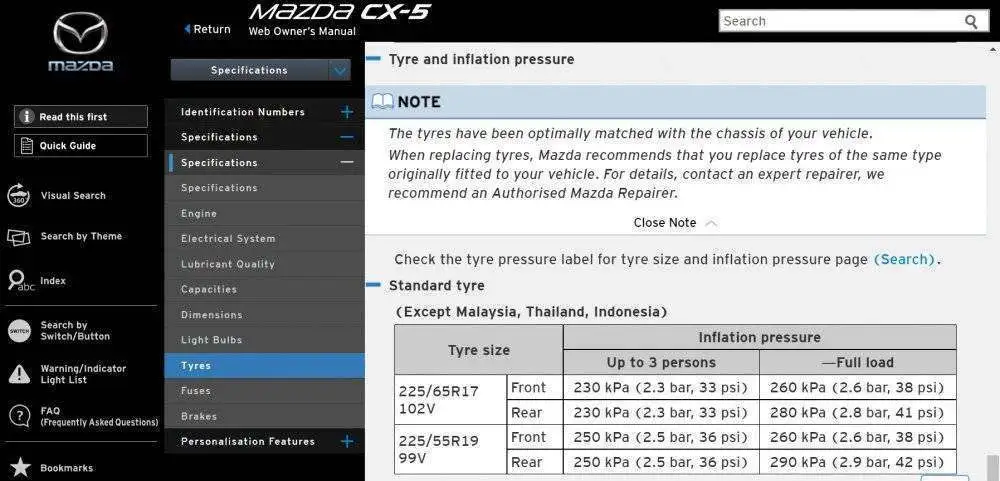

Yes. And this’s Mazda’s tire pressure recommendation in the manual and on the gas filler door / door jamb worldwide:Get a decent pressure gauge. Run what's stated in the door jamb or manual. It's there for a reason.
See above.Let's list what's stated by Mazda?

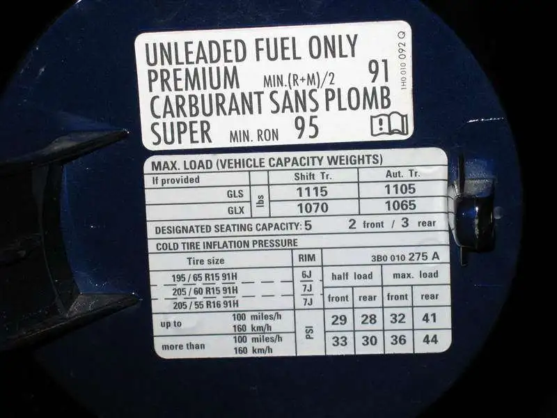

No, I’m not. See my previous reply. Actually in the old days we usually need to put 3 more psi while driving on the highway as stated in the owner’s manual. More recently, higher tire pressure is recommended when you’re driving at high speed (>100 mph) such as this tire pressure label on the gas filler door from my 2001.5 VW Passat.It's got to feel uneasy and even unsteady at highway speed.

The proper pressure depends on weight on that axle. Only that will give you the correct AND SAFE contact patch size. Get a decent pressure gauge. Run what's stated in the door jamb or manual. It's there for a reason.
