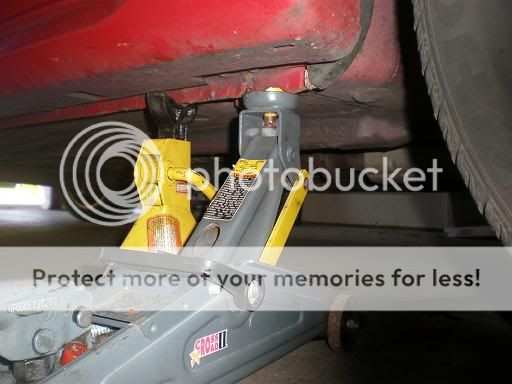

Jack up the car, take off the wheel, remove the center cap.
Put tire back on and tighten at least three nuts.
Drop car back down until enough weight is resting on the tire.

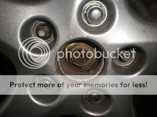

Un-indent the nut (you'll know what I'm talking about when you see it)

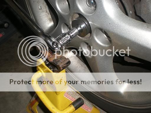

Put 32mm socket with a very long breaker bar to break lose the axle nut. Support the breaker bar so as not to slip/round the nut.

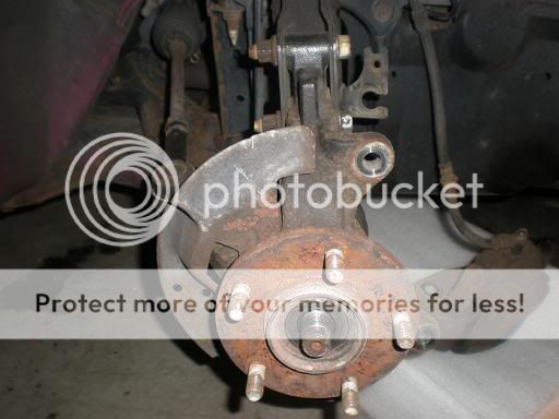

Here is what you're left with.

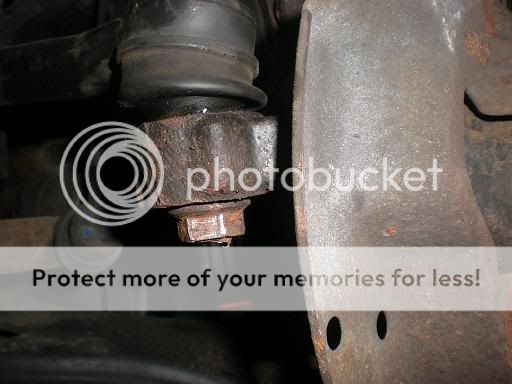

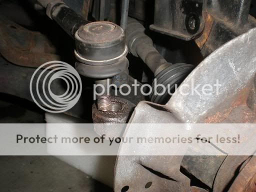

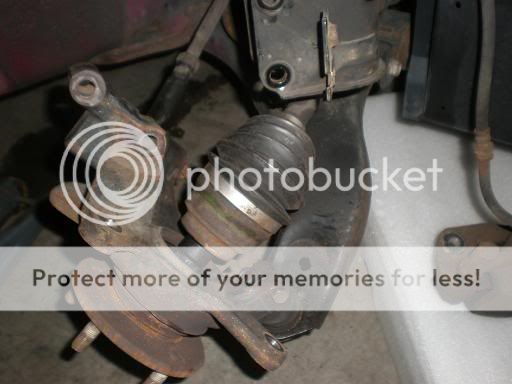

Remove cotter pin from tie rod and use 17mm socket to remove nut.
Leave nut on and bang with a rubber mallet to loosen joint.

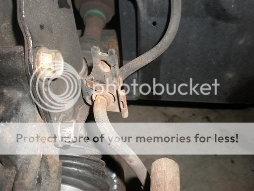

Remove hose clip

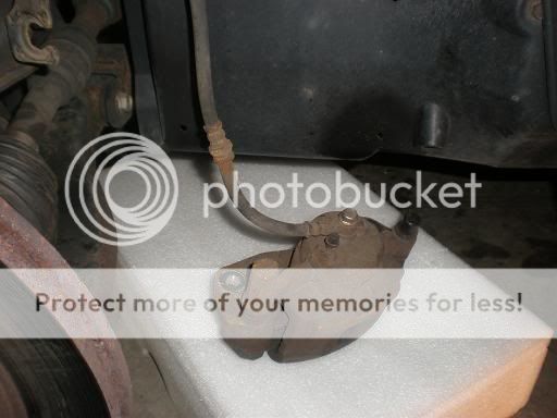

rest caliper on something as to not put any weight on hose.

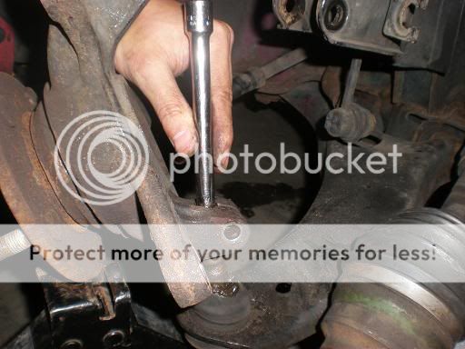

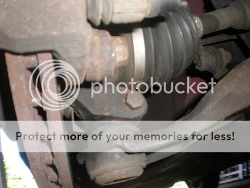

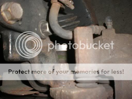

I believe this is a 14mm. Nut is on other side of this picture. You might want to soak this in PB Blaster for a couple days prior to working on it.

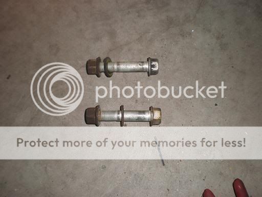

remove bolts from strut. 17mm

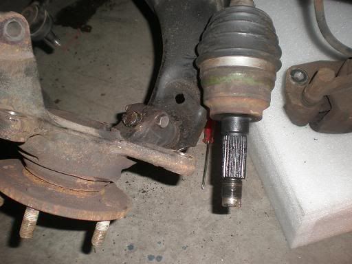

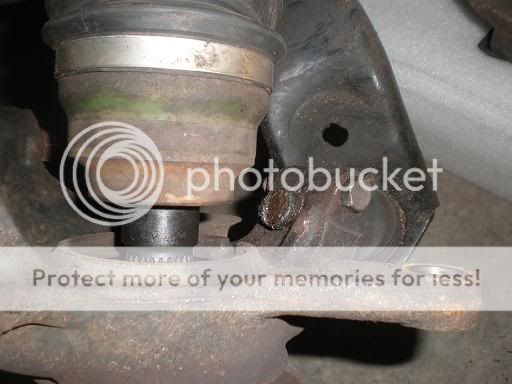

remove axle. It slides into/towards the transaxle.

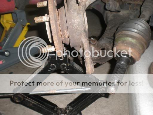

prop up hub from the bottom
take a tap and tap out the joint.
Here you go.

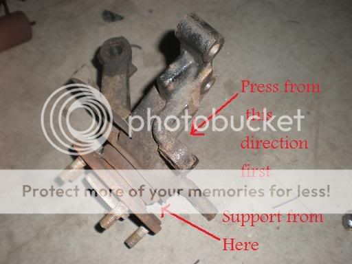

No pictures of the actual pressing of the bearing. I recommend a 12 ton hydraulic press. Mine was really stuck.
Press out the bearing from center from the back (part towards car).
The spindle will pop off first.
There is a C clip that needs to come off before the rest of the bearing will come out. Mine was rusted on, but it did come out.
Center of bearing race will stay with spindle.
Use chisel to take race off.
Continue pressing the rest of the bearing out after C clip is removed.
