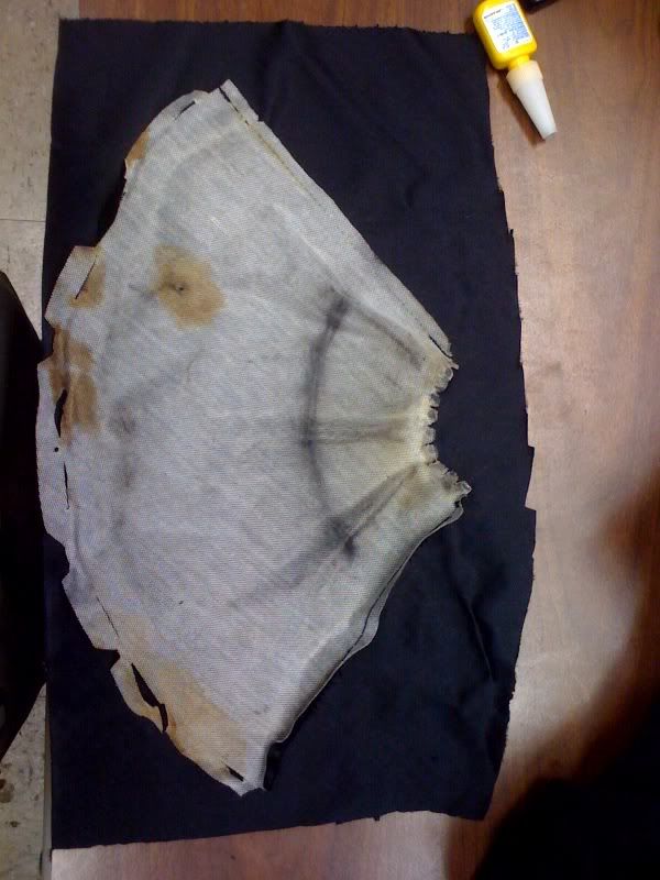

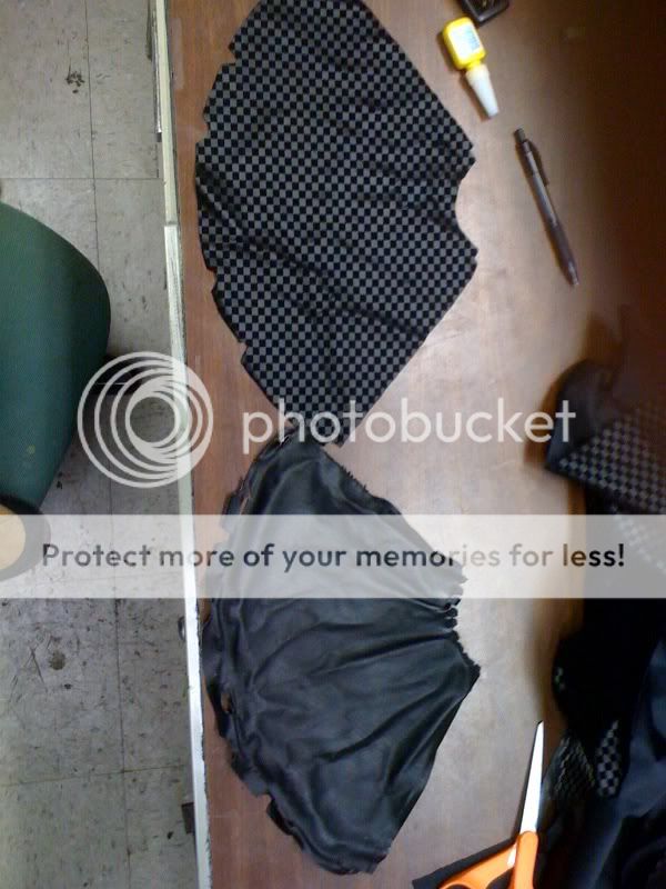

Now lay the shift boot on the opposite side of the material. Trace the shiftboot onto the material. Make sure that you copy the openings where the boot was held down. This will make it easier for the installation.
Now cut what you just traced out. Double check everything making sure that you copied the old shift boot.

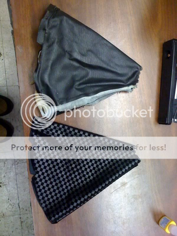

Flip the material inside out and fold it so that the ends are touching eachother. What I did here was staple the ends to gether so that when I sew it was easy. Sew the ends together. (go about 1/8th of an inch from the end.
Now flip it inside out and this is what his shift boot will more or less look like.
