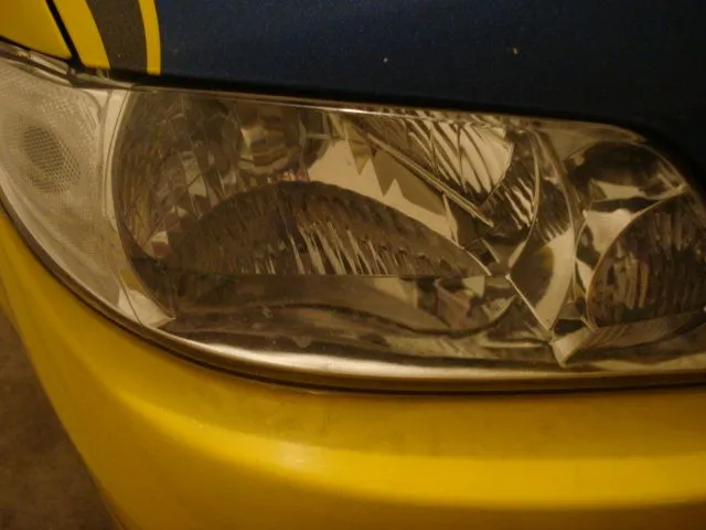

I got the E55-R shrouds. I was thinking about darkening the bezel but not as dark as black tho. Here are my headlights. Should I keep the clear corners?

do what makes you happy. If you darken the shroud I think a clear corner would look funny. I'd go with even tones.. but I refer back to my first sentence.
well, currently you have a very "bright" setup. Basically everything on my car is grey.. so I'd stick with that if it were mine.. you could go either way though. do you like chrome, or would you like it to be more subtle.
basically I'm trying to get you to answer your own question here... lol
so it'll be similiar to my setup?
I've got the sedan lights with Acura TL's and E55 shrouds
