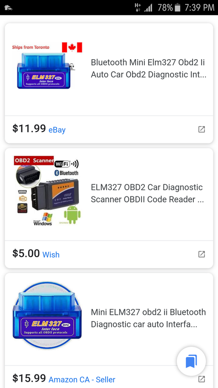

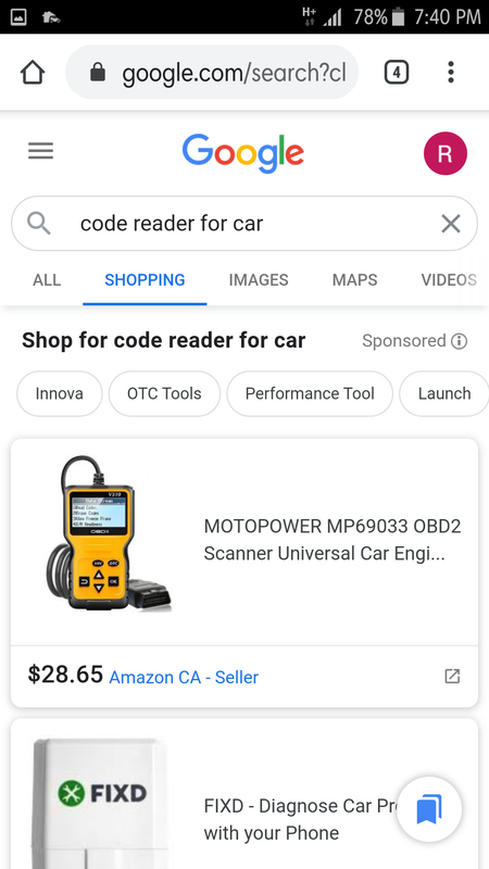

Those were screenshots I posted.
I will try to post a link...

You should get one of these.
It would be nice to know if you threw the same code...
This one broadcasts to your smartphone.
This one is self-contained.
No blue tooth or wifi needed...
