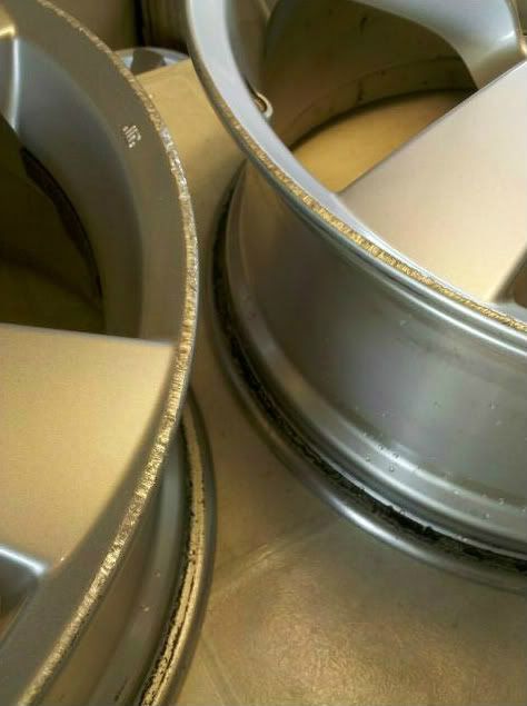

The damaged rims who met too many curbs:
I ended up using my random orbital sander (sorry no picts), with 100 and 200 grit sandpaper around the perimeter of the rims. As you can see, there was extensive damage around all four rims. But here is an example of the process on the face of the rim.

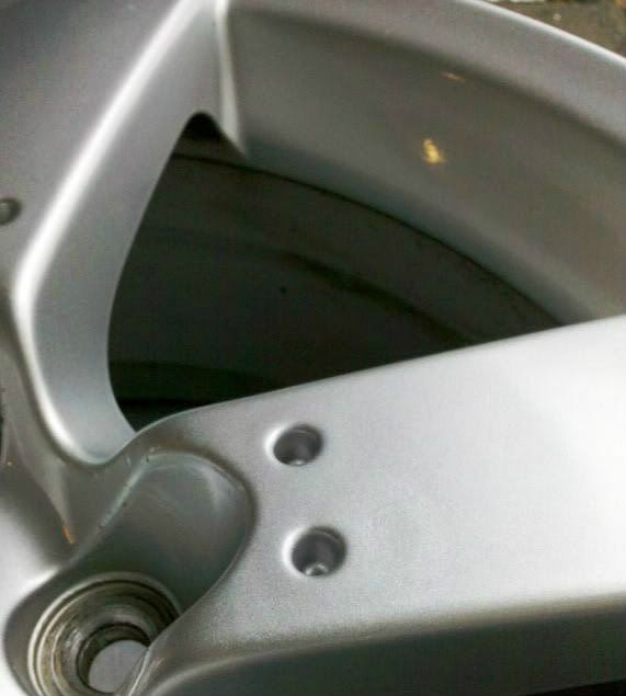

Damaged spot (from a rock or similar)
Sanded with 100/200grit by hand
Painted and finished!

- So, did you paint only the sanded areas, or the whole wheel?
Painted just the sanded areas, curbed or rock chips were sanded, cleaned, and spot painted to my liking.
- Just one coat? Two? Three? How long between coats?
As many coats as it took to cover the sanded area and blended (sorta) with the rest of the wheel. Sometimes up to five coats I'm sure. Less damaged areas took 2 or 3 coats.
