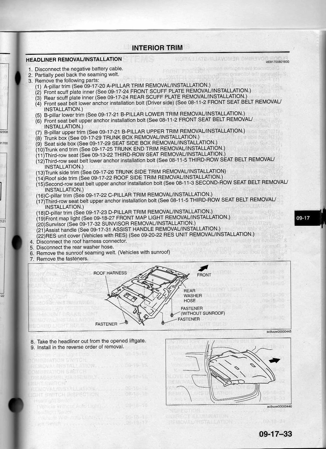

Has anyone removed the headliner on the CX-9. Im planning to install a flipmount dvd myself and would like to know if its easy or hard to have it removed. Its not equped with a moon roof. Im pretty good with DIY proyects and if I can save the install money Ill go on line and buy one. Since the same flipmount dvd that are sold in store you could find them online for about $75 to $85 less.

No. I haven't. If you need a page (or two) from MAZDA workshop manual of HOW TO REMOVE HEADLINER, I certainly can scan one for you tonight.
Is that what you need?

YES! That'll be great and could be very useful.
I’d appreciate that information. I’m planning to buy an aftermarket flip down DVD. It’s a Tview T90DVFD not every expensive but my girls won't notice a diffrence. I went to an AV store and they had it for $249.99 and the install for about $150.00 with 1 a year warranty, but I found the sameone on eBay for $ 159.99 with a 2 year warranty. I’ll save a lot and in these times we need to.
Now, on the power tapping I was planning getting the power from the middle dome light but, if you have a better suggestion pass it on. Do you think I’ll need any special attachments to hold the filpdown DVD to the headliner? I don’t think so, since the weight of the equipment is 4.8 lbs. If you could send the sacan to

Please see the attached page for headliner removal from WorkShop manual.
It consists of many steps, each refers to another subsection.
As SportsOwner said, it seems very involved to take out the headliner.
Do you really have to do that?
If you need a manual page for a specific area (certain trim), let me know.
For now, I don't think scanning 20 pages to you makes any sense.

How else could I install the Flipdown DVD? I want to know where I'm screwing the eqpt and I would not want to damage the roof.
For $200, I don't think that the AV store technician will take the headliner entirely off to do the job. Last time I asked (for my minivan once), they seemed to cut into the headliner and use some kind of adhesive to fix the unit to the roof. I am not entirely sure. Try google (or Bing) it on the web to see if anyone has done it and posted photos.
As I said, if you have troubles removing any specific piece, let me know, I will post the corresponding page for you.
I have no tips for the power tapping, but SportsOwner's suggestion sounds good to me.
I have Workshop manual, which you can also buy one if you are interested. Another useful one is the Wiring Diagram, which I have not acquired yet. These are useful in preventing DIYer from messing up. Kind of "look before you leap".
If you need instruction on how to remove B-pillar trim, I can send you the page.

Yes, please send me the instructions on how to remove the b-pillar trim lower and upper also could you send me on how to remove the A-pillars, the front scuff plate inner and the front map light. I'm thinking in removing that front part so I can lower the headliner and take a good look of what's in between the headliner and the roof and find a good spot where I can secure the DVD flipmount....

Sure. I will send it to you as Private Messages tonight.
A-pillar is slightly tricky. Read the manual pages carefully.

I'll have that in mind. I'm thinking in pulling it down just enough to take a look and find a secure spot to mount and route the pwr. Also to make sure a don't damage any wires.....
gavilan_pr,
Just sent you the link to 3 jpgs of A/B pillar removal thru Private Message.
Good Luck
