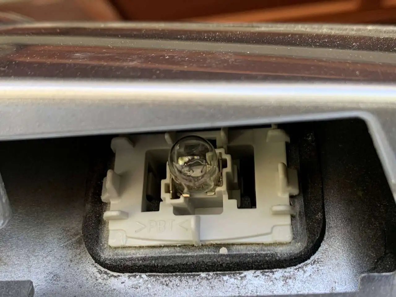

The problem that so many have (yours truly included) on removing the lens of the license plate light of a 2012 Mazda5 is that the picture on p.8-46 of the Owner's Manual is confusing! The barbs of a Stanley P2514 lamp has the barbs/tabs on both the short sides facing outward. So the prying direction of the screwdriver handle should be inward and down, levering the shank of the screwdriver on the convex lens, thus lifting the edge of the lens outward. The manual shows a dark arrow on the left, which is supposed to indicate the insertion of a flat-head screw driver, but could be taken as the prying direction. The hollow arrow (second left) shows the direction of prying.

Thanks for your suggestion, but it borders on killing a bug with a sledge hammer. I had extreme difficulty prying out the lens of the first one, because the instruction in the Owner's Manual and the various blogs did not address the root cause of the problem. Once I figured out the CORRECT PRYING DIRECTION, the second one popped out in a few seconds.
