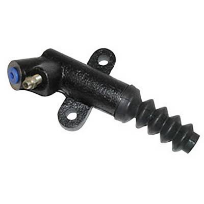

You'll need to drop the whole thing. For the clutch actuator, the bolts go through the middle of it.
for example...
