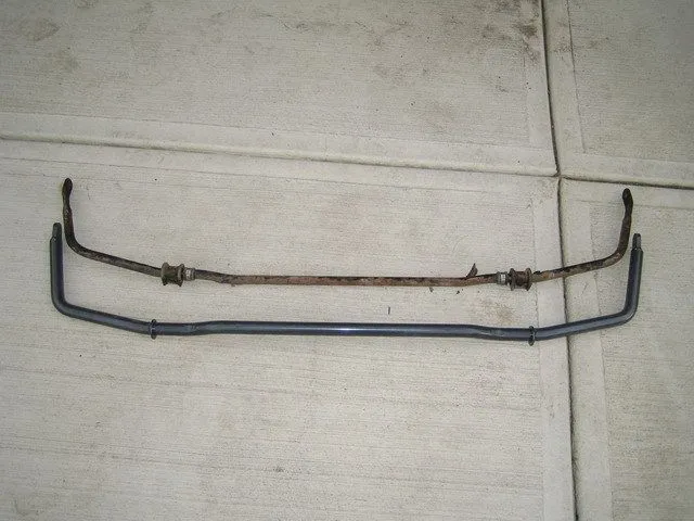

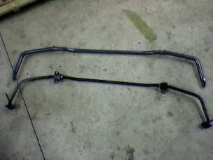

Progress swaybar length??
Could any of you Progress rear swaybar owners comment on the length of the bar in comparison to the stock (ES) bar. I dug up these two picks, but it's still hard to tell. In one pic it looks the same just thicker and in the other pick it looks longer as well. The reason I'm asking is because I had to buy some shorter miata sized endlinks to get rid of my clunking and a longer bar such as AWR would probably not work well with them.
