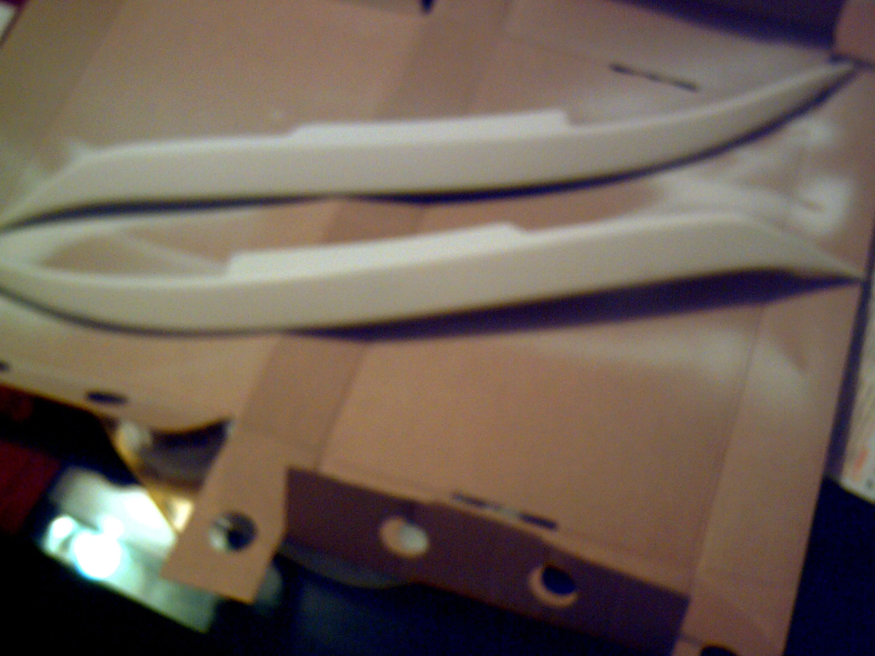

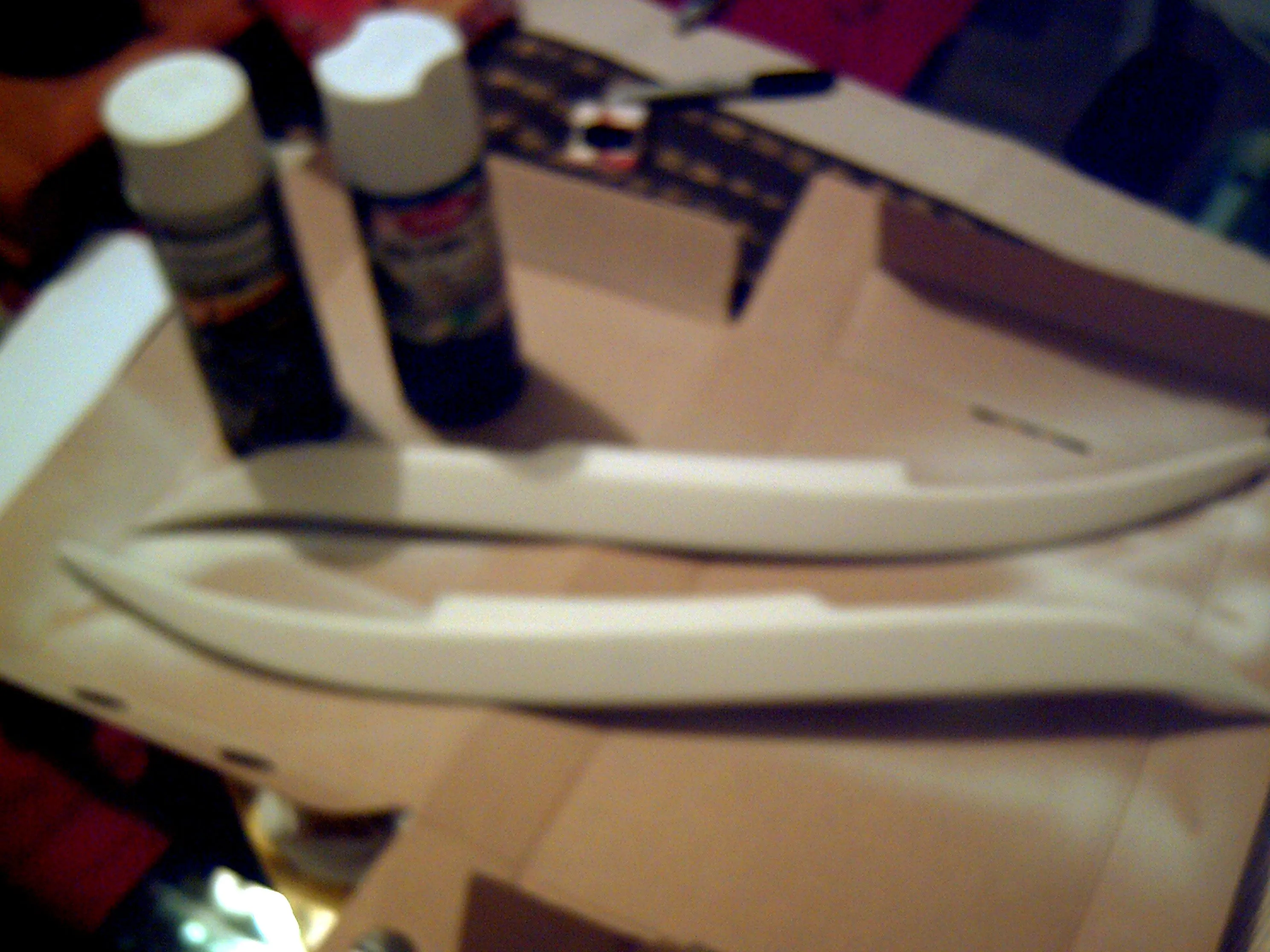

So, to start off, I bought my eyelids off of eBay for $19.99. they did not come pre- primed. They are made of ABS plastic. Here's all the items needed.
Parts & Paint
-Color Paint code for your car (I have the Liquid Platinum MS6, the code is 30S)
-OEM Spray paint for base coat.

-First, clean the entire painting surface with a 600 grit paper. Rough the surface up enough so the primer will cover well. Then, after about 2-3 coats of primer (lightly sanding in between with 1500 grit), use a damp cloth to remove all small dust particles from the surface. It may get a bit messy, so try to do it outside or a well ventilated area, I did it on my deck.

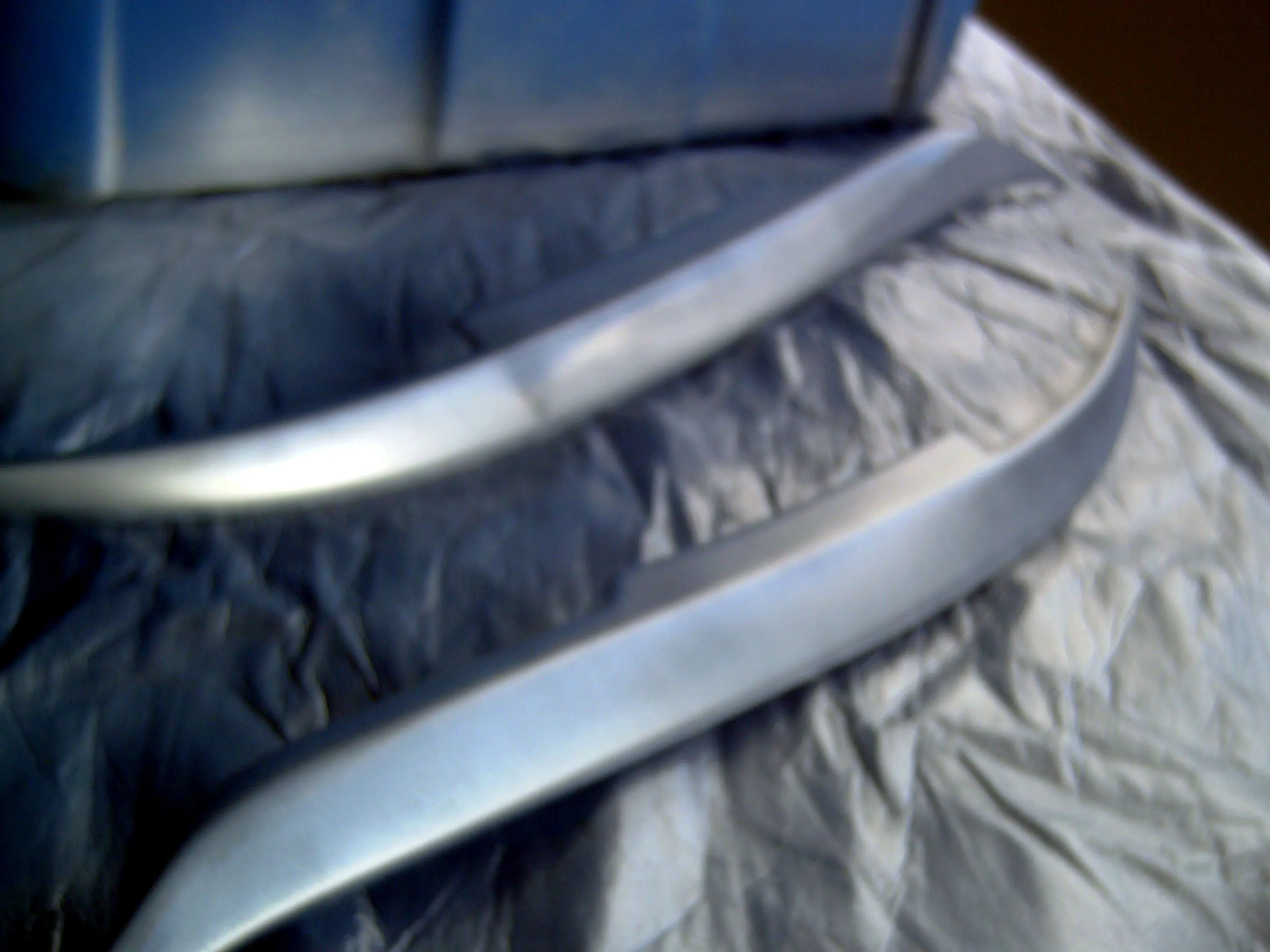

-Then, once you have a nicely covered surface, front and edges, use the base coat paint that you got from your dealer. Use paint in a slow-swift movement across the surface of the eyelids. **The thinner, swift coats, the better the finish**
-Once you have covered the surface of the eyelid with one good coat, let it dry completely for roughly an hour. Once dry, use a 1000 grit paper with water finishing with a 1500 to remove any little particles between coats, still wet sanding, not dry sanding. Repeat until you have roughly 3 coats of base on the surface.
-When all base coats have dried, use the 2000 grit paper in a very slight manner with water. Remove particles with water and a light rag. Dry off completely and let sit for 10 minutes.
-Once dry, finish with at least 3-4 coats of clear coat, allowing 1-1.5 hours between coats (depending on temp). Use the 2000 grit paper between coats with water. Allow to dry.

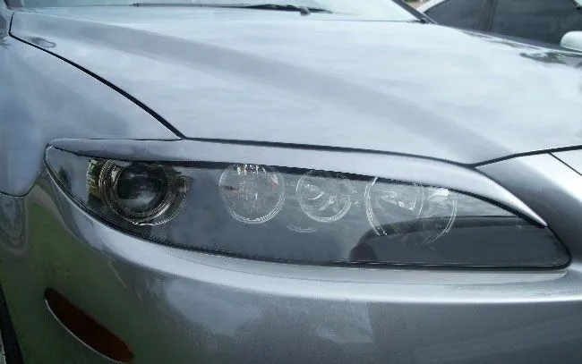

prep area for install; I washed the are with a wet rag and dish washing soap, to get rid of the oils and debris. I heated the inside of the eyelids on the double side tape to make it extra sticky when attaching it to the light.

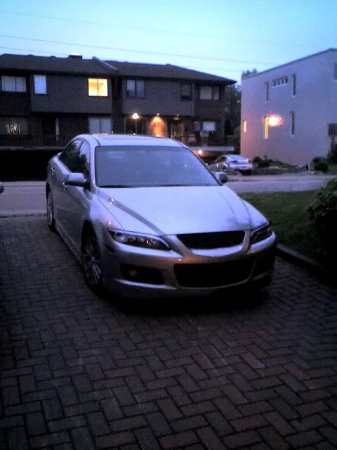

sorry for the poor quality pics my digi cam broke and i was forced to use my cell :/

and this is what my MS6 will look like in the future!!!!

I'm diggin the open front end ... I wonder what a black mesh would look like on there.
man if you can make it id pay!
i was thinking of getting the auto exe looking grill, and bringing it to the garage, seeing if they could cut that midle piece and fill the holes and paint.
