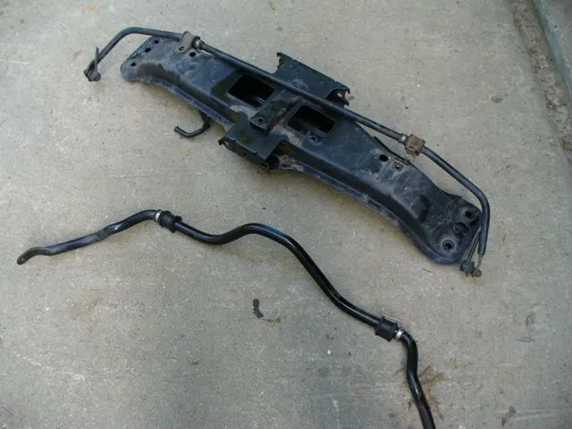

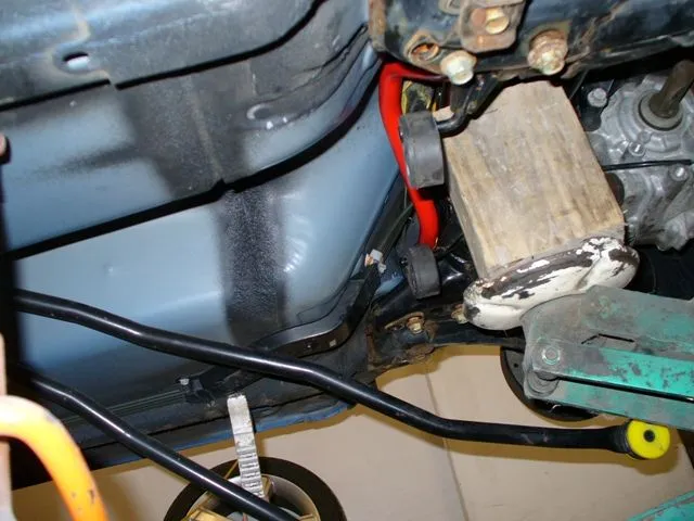

Got my front bar installed today the motor mount is the hard part but I know the trick to it now.

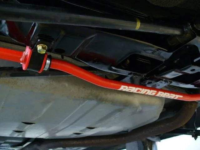

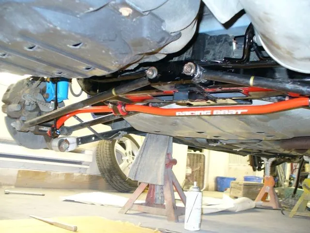

Rear bar much easier.

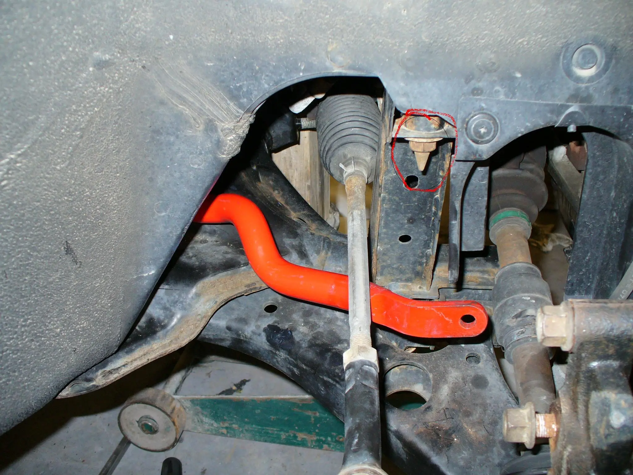

Did you take the bolt out through the rear motor mount? Or what about the bolts on the sides ill show you a pic in a min.
These bolts you will want to put a jack under the crossmember also.
i have the jack under the motor, but i didn't take the downward bolts out. ..i guess that's what it is.
thanks man. I'll maybe try it tonight.
Yeh I had to take those out and just drop the whole thing down makes it much easier. You dont need the jack under the motor you need it on the crossmember the motor will be held in fine with the side mounts.
