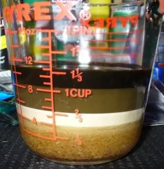

This is a superb write-up! I used it for reference when I installed my OCC (Saikou Michi, Matt Damond kit) last May.
At first, I was getting very little fluid in the OCC. The first three changes (intervals between drains were 932, 1471, and 3348 miles) all generated less than 2 oz. of thin, gritty black fluid that smelled of gasoline. When I let the samples sit overnight, none of them separated.
Then, all of a sudden, I was getting tons! Next OCC drain interval was 1364 miles and I got 12 oz. of fluid. This was in November, so weather was getting colder. Only other difference was that I unscrewed the drain plug on the OCC as much as it would go. Last drain interval was 1633 miles, and I got another 11 oz. of fluid. This time I had to shake the can back and forth (with the drain completely loosened) until I couldn't hear any fluid sloshing around anymore. It seemed to be clogged at the beginning, but once the initial sludge came out (ice? It is January), the rest came out in a torrent. Attached pic shows the result after sitting out for a couple of days. Looks similar to the pic at the top of this thread - reminds me of an upside-down Guinness.
I find it hard to believe that I wouldn't get anything in the can for 5 months and than all of a sudden start collecting this much stuff. More likely my drain technique was off. I would suggest 1) making sure drain is completely unscrewed (something like 10 revolutions IIRC), and 2) shaking the can gently back and forth to dislodge any sludge blocking the drain. #2 will also help discover whether there is fluid in the can. Hope this helps.
