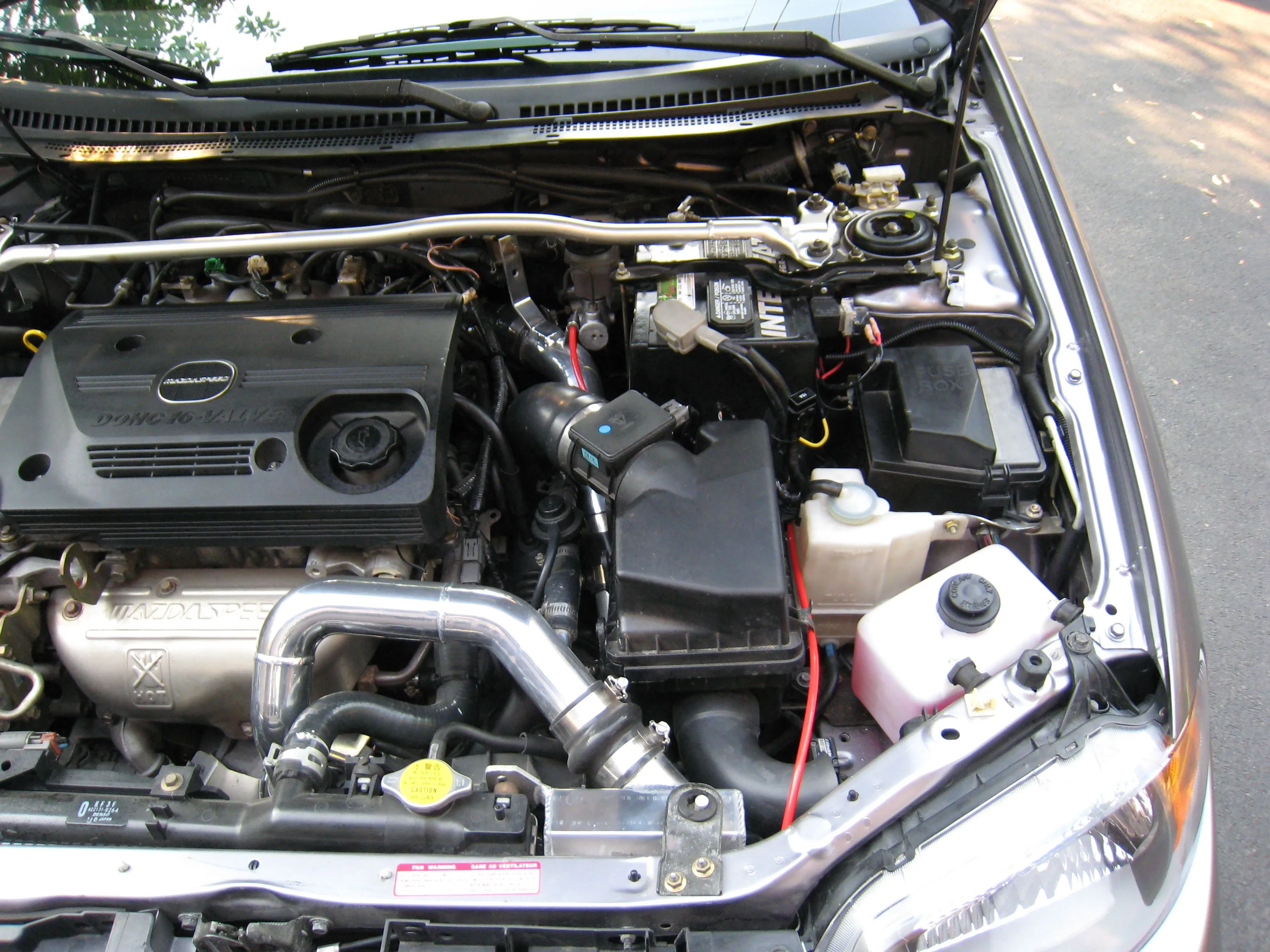

I took off my horns in order to install the pump right below the tank. I also never really use my horns, even though I will probably end up re-connecting them because it is not exactly safe to run without a horn, especially if you drive like I do. Notice the red line that replaced the windshield wiper hose, this goes to the pump inlet. Hook up the ground, run a power line to the controller, and run the line into the engine bay for the nozzle.
Tap a hole for your nozzle. Try and make it as strait a path as possible and right before the TB, as to minimize pooling of the meth/water. Put together your nozzle and screw it into your tapped line, then put your IC assembly back into the car and run the line to the nozzle.
I put my controller near the MAF to minimize the amount of wires I had to run. Use the pink wire as your MAF voltage wire, the kit includes a wire tap, I used it because I suck at saudering. Run the power and ground to the controller. I used the fuse box as my 12v power source. Run your power line to the pump and make sure it runs well by tapping the power line that goes to the pump to the positive bat terminal. If water shoots out the hose and all over your car/yourself then it works. Once you know the pump works, connect the hose to the nozzle.
All the wires nice and clean, kit installed. You can also install the LED that comes with the kit. I didnt notice that there was one until everything was wired and cleaned up, and it was about 2am, so I dont have one. And don't worry about that huge heater hose I have coming out of my intake pipe, it is my recirc hose to my BOV and I just have not put it back on yet.
