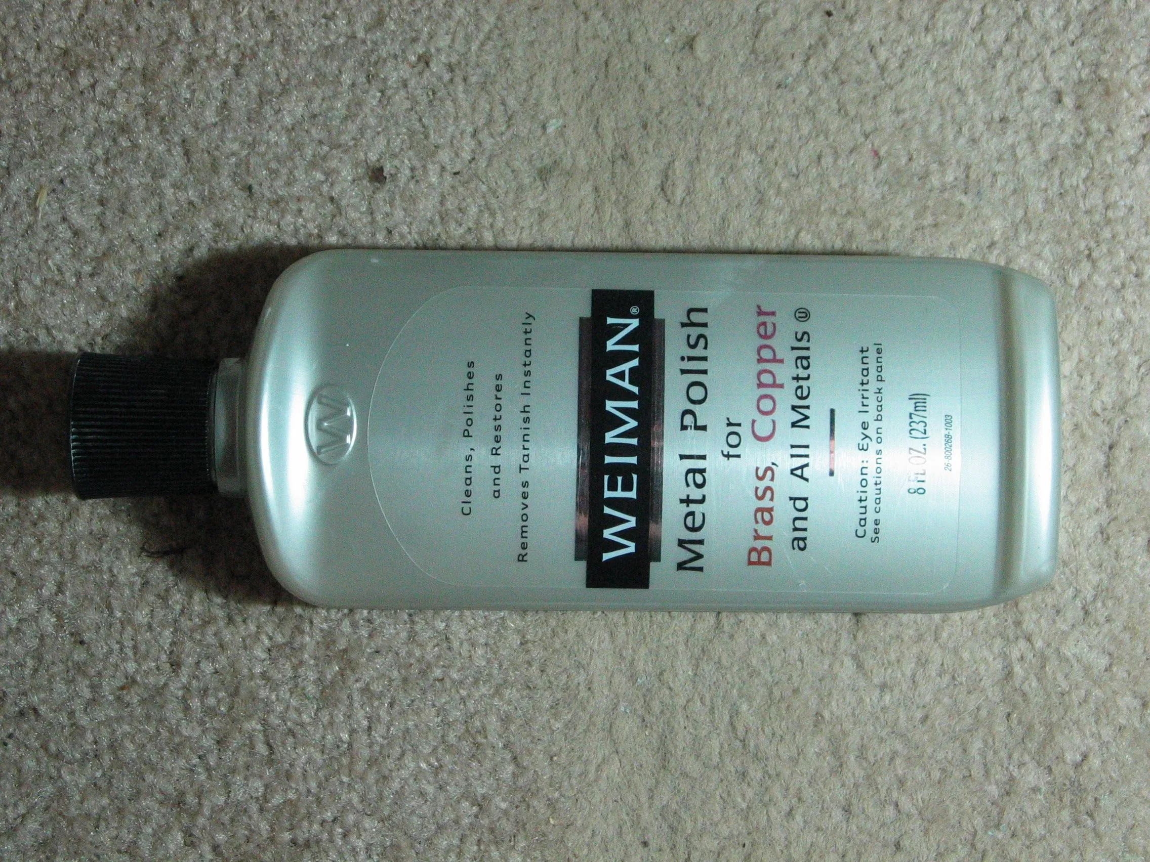

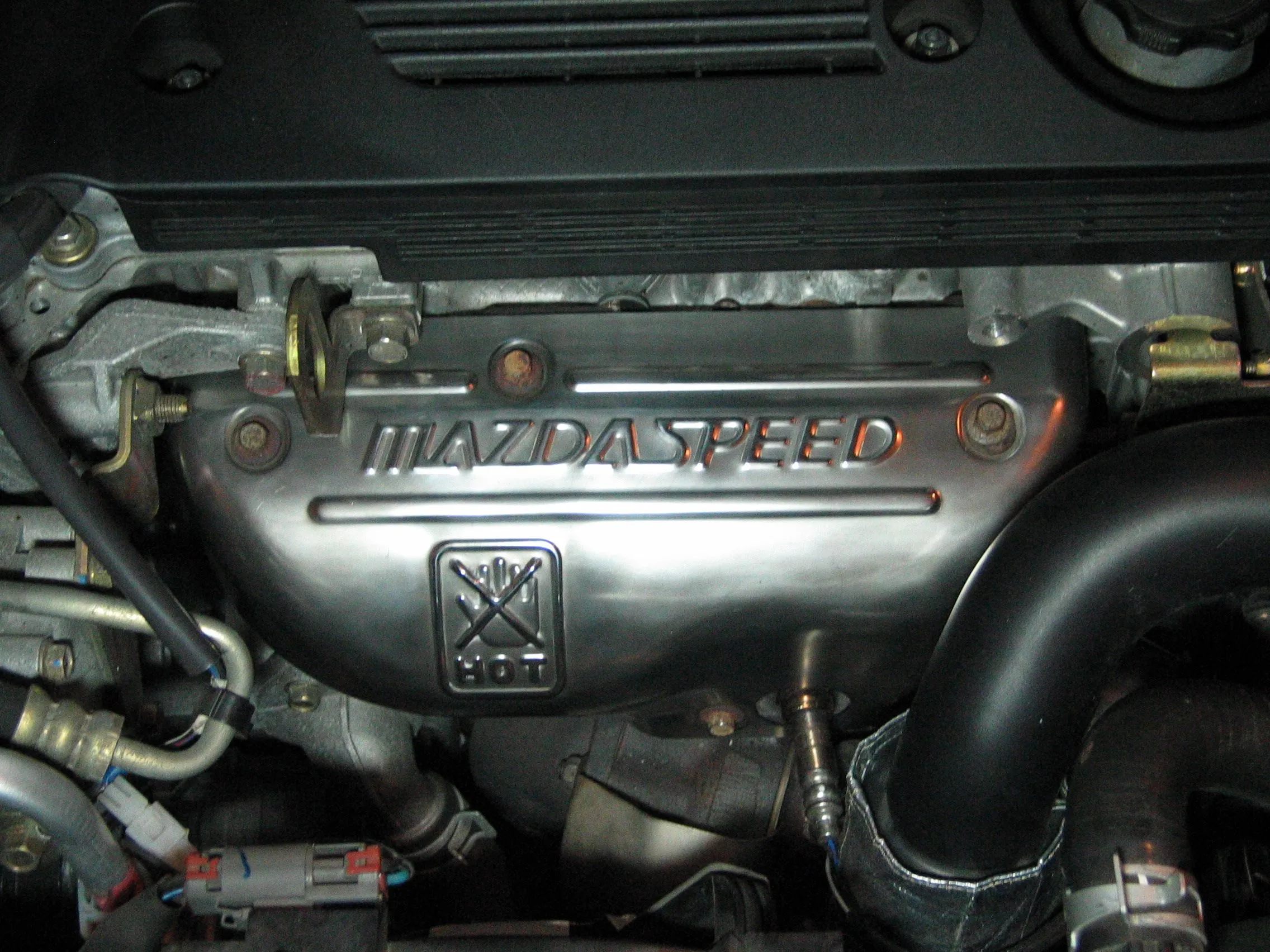

just finished mine up tonight. here's what I did if anyone cares. Started with the solid rubbing compound (pic 1) and a hand drill buffing wheel (both from home depot). I used the stick like a crayon and rubbed it all over the HS. After that I used the drill/wheel and buffed it all out. the results were not that impressive at all. So I decided to try it again. Colored the HS with the stick and went to town. Results were a little better. So I decided to run to the hardware store and get (pic 2). I applied a generous coat of the liquid polish and let dry about 10min. buffed out and KABOOM, results. but still not ulta shinny so I did yet another coat of the liquid polish. pic 3 is my final results (don't mind the rusty bolts, they'll be changed out by this weekend). I've seen way better jobs but here's yet another way. Sorry the pics are kinda bad it was dark out so I used my shop light. I definately recomend a bench grinder/buffing wheel, and don't go cheap on the buffing wheel, i did and it sucked! BIG thanks to ZenProtege for the original how to!! I went everywhere to try and find the 3M polish. I guess I should've just talked to my buddy how works for 3M.
Good luck to all and happy modin'

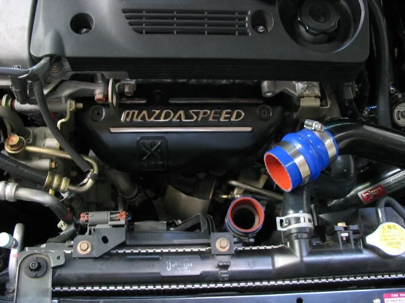

well i couldnt get it as shiny as i was going for... so i decided to try a different approach.
not the best paint job ever, but i figured i'd wait and see if this paint holds up before wasting more time perfecting it.
Thats what I wanted to do, let me know how it holds up.
I started to polish mine and it came out great!(boobs)
BTW, Wiggles. Get some high temp blue paint that matches your hardpipe silicon adapters and use that to paint the Mazdaspeed that you left unpainted(thumb) . If you use the light blue I think it would good with the black.
