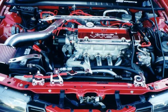

I had my valve cover chromed on my Prelude by a Harley shop and they told me not to waste money on expensive metal polishes. They said just use wax when you feel like it. This is the Prelude's engine 3 years after the chroming was done. No cracking, fading, discoloring etc.
Mark

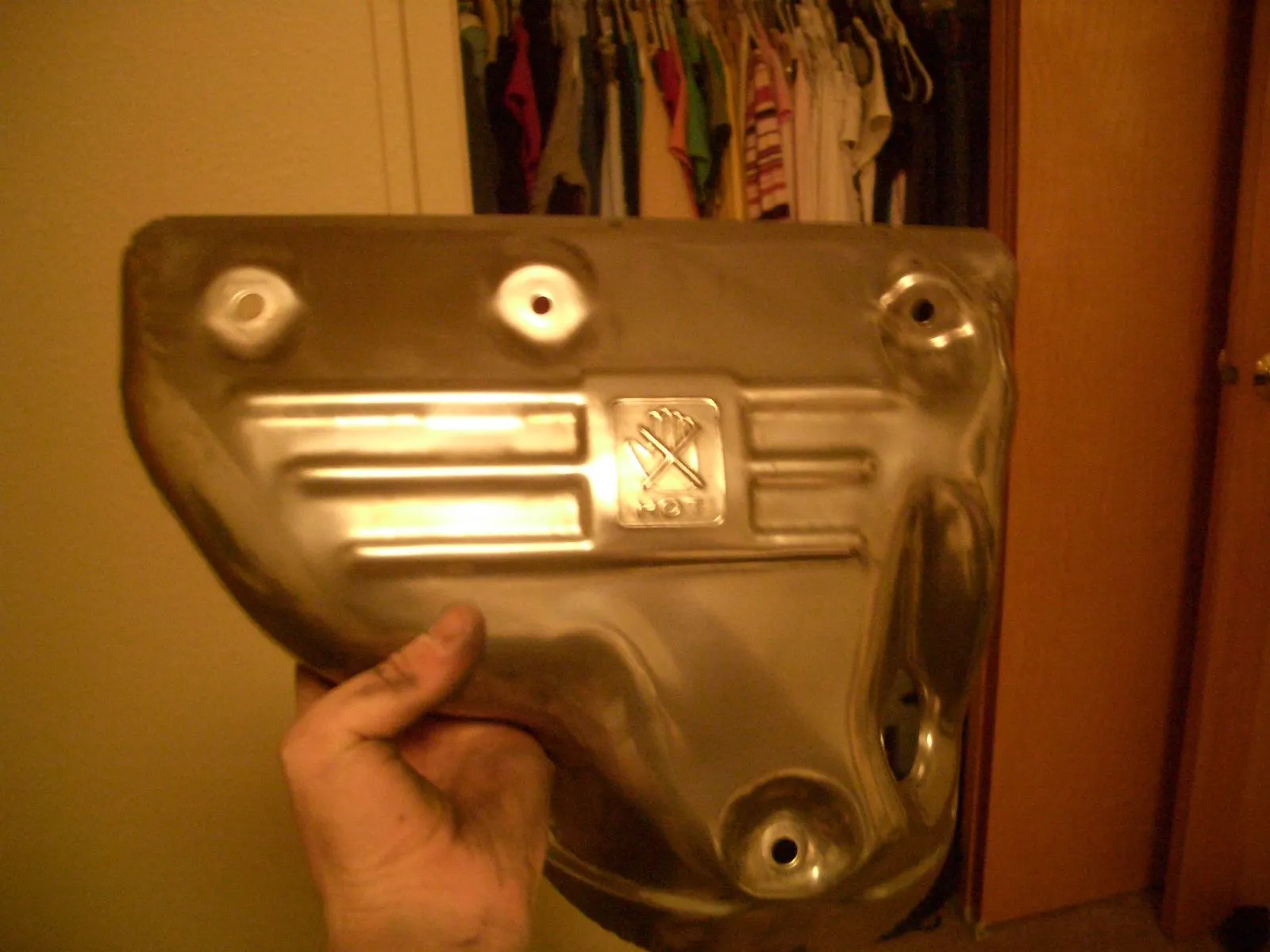

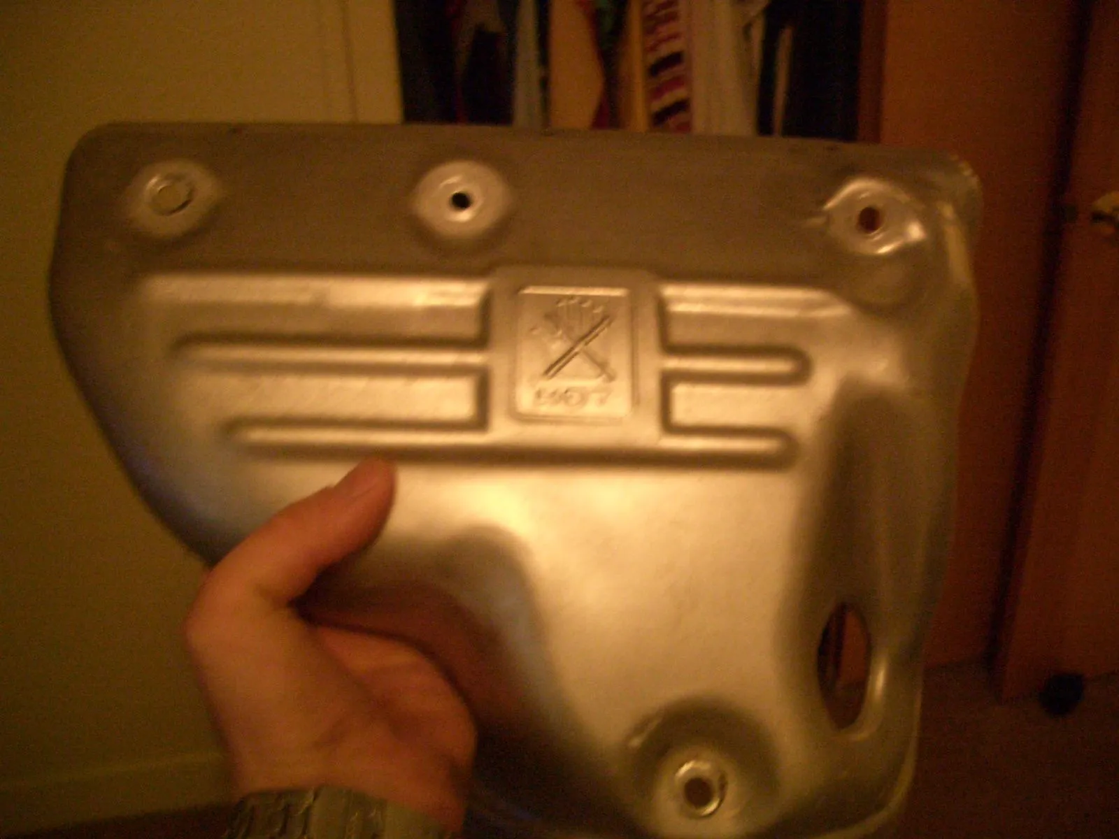

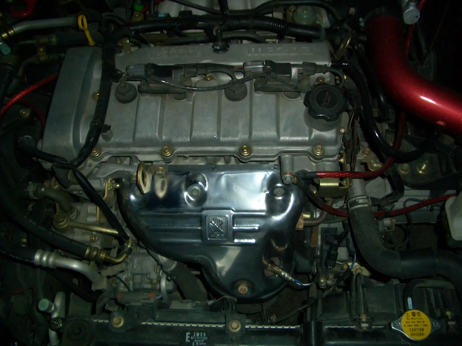

uhh, I uhhhh, tried this today. And after about 3 hours of buffing (headshake , I've come to the realization that the compound I got was too fine. Look at the before and after pics below. There's also one of me after I finished, too. See how dirty I am? yeah, I'm a dirty boy.... (lick) Last one is the HS in the car.
Maybe next weekend I'll look for a rougher compound and go at it again.
Edit: oh yeah, and wear some eye protection and a mask if you use a dremel. The s*** flies everywhere

So you used a dremel to do the buffing? If so, that is one problem. How did you get that dent in the HS? Get a little upset?
If you use compound bars and press the bar against the buffing wheel it will coat the buffing wheel and not fly everywhere. It took me 5 minutes to buff my HS, and it took no effort, I did not even have to press hard. I had a high speed grinding wheeel with a big round buffing disk (like you see in my attachment a few posts back), and used compound bars. I stayed clean as well.
