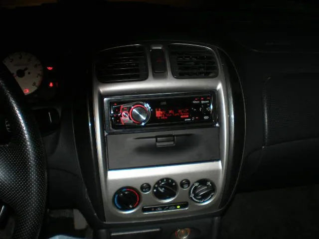

Mine after a really rough time pulling the stock deck out:

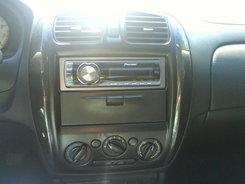

I did this a while back and never posted the install pic, it's just like everyone else's, but it's the best dash kit for these cars by far.

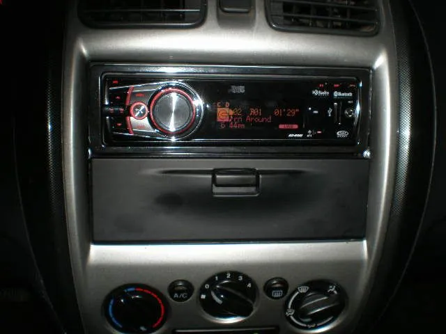

Here are pics from my setup with the OEM open pocket and support bar. I was trying out two different JVC units. I winded up settling with the 2nd one since it's $70 cheaper:
Looks good! I think I have the same JVC unit in my CRX. The bottom one, lit up orange/red. Eventually I'll get my OEM out of my Protege.

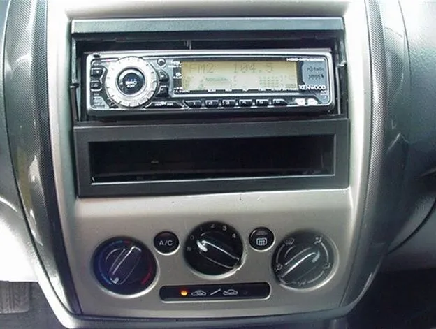

Broken Bezel
So i just bought my 02 P5 last week, I will officially have it in my possession this coming friday, one problem with it is the previous owner broke the radio bezel when installing an aftermarket head unit. Wasn't too sure what he was thinking.....?
Heres a picture of it: radiobezel.webp
My question is, is this a different set up than what is going on in the How To?
And to fix, will I need to buy both the parts listed in Post #1 or just the bracket?
Thanks so much!
-Gabe
You will need the bracket and the pocket. I posted a pic of what the real OEM pocket looks like back when I had my P5, it's a few posts up. It came standard in MSPs, MP3s, and 99-00 Proteges so they aren't too expensive or hard to find.
