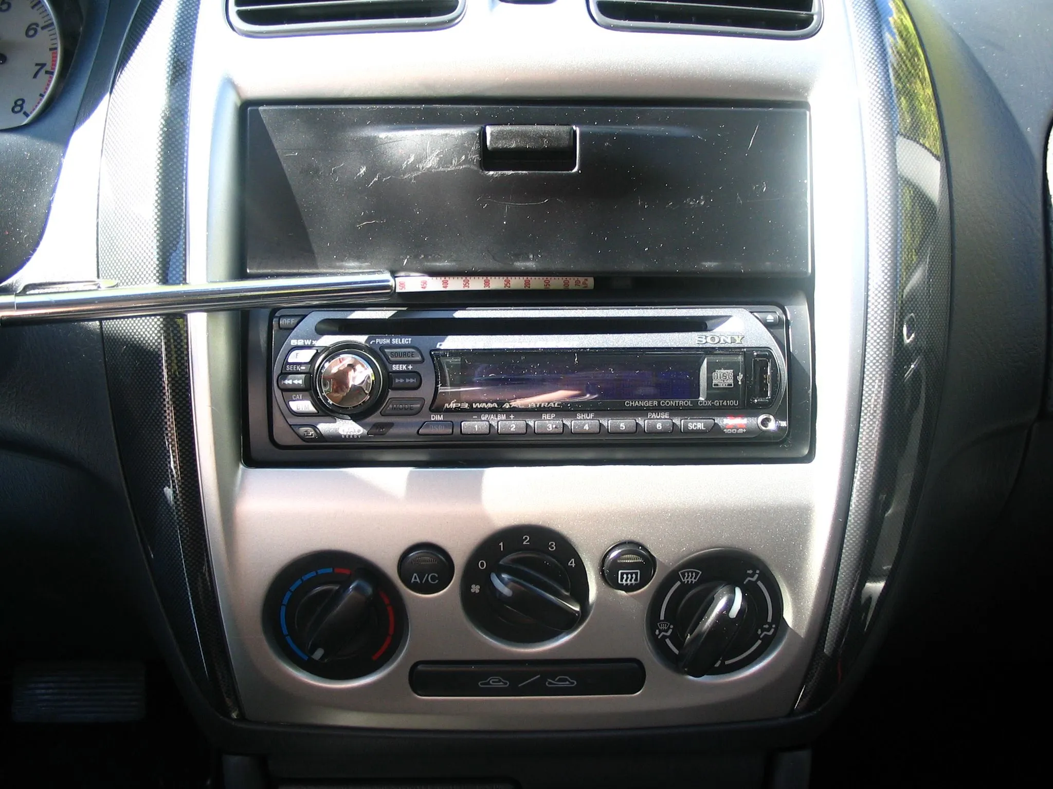

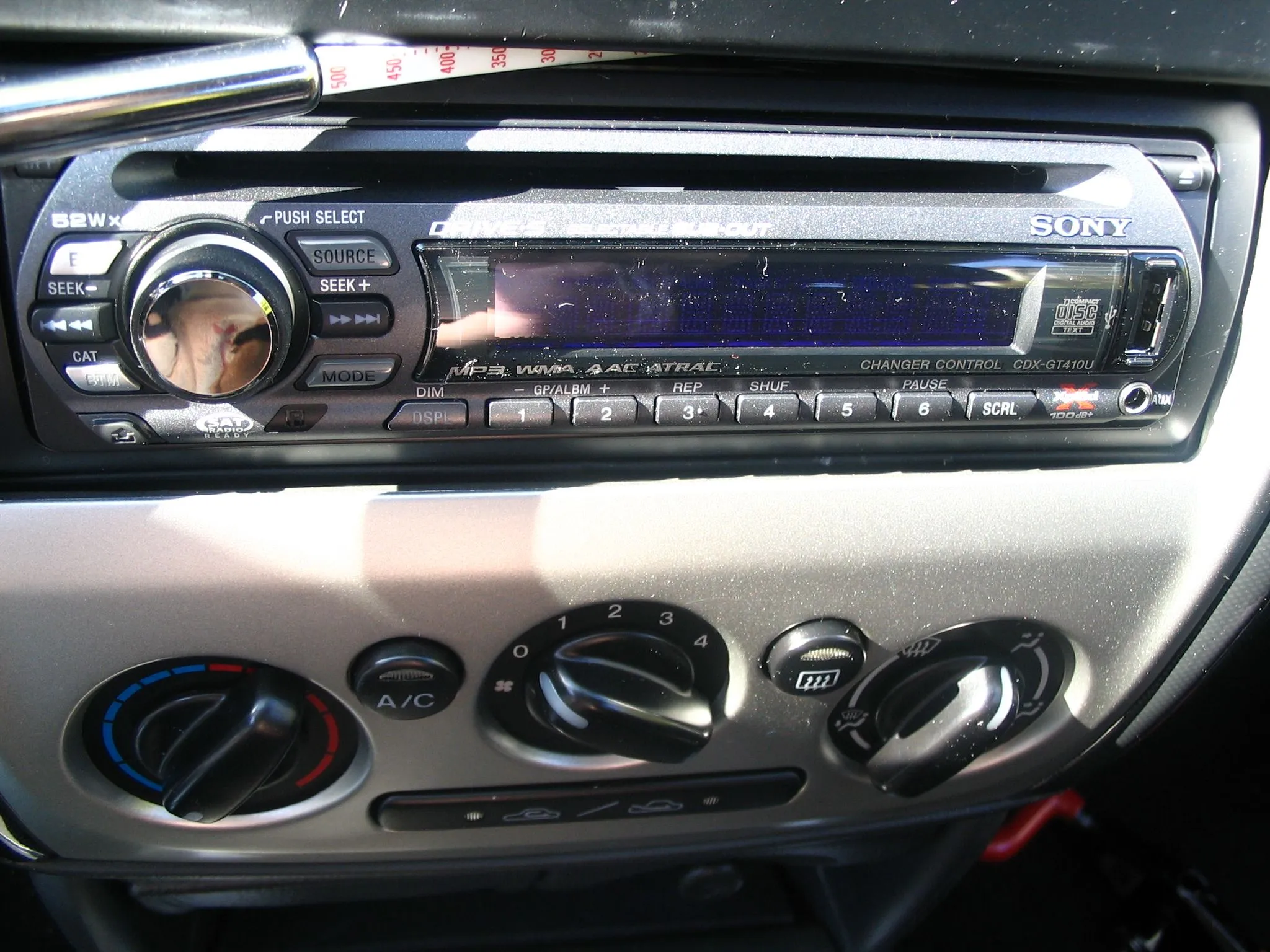

...edit for pics...... GHETTO looking install! I just did this install with the pocket up top. Well, without the support bar, there's too much space for both faces so the pocket just flops around(pic. 1). The rear support on the pocket looks like it has a locking tab but it is much too small to "lock in" to the metal support bracket. Anybody know the purpose of this? Also, the HU sits in too much- I secured the HU sleeve in well, can it be held out with some sort of spacer - how do you keep it flush with the face of the pocket door/bezel????(pic. 2)

HELP! where can I find the bolt that screws into the back of the head unit? I've tried every auto parts and hardware store in my area, as well as a few custom audio shops, with no luck! I need an M4 that is longer than 20 mm so it fits through the rubber grommet.

install the msp pocket into the lower part of the frame (plus the additional front bracket of course), then you wont need additional stabilisation of the headunit in the back... (it shouldnt be so hard to get a M4 with more than 20mm ???)
