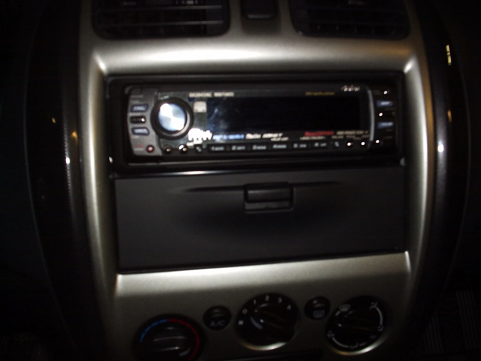

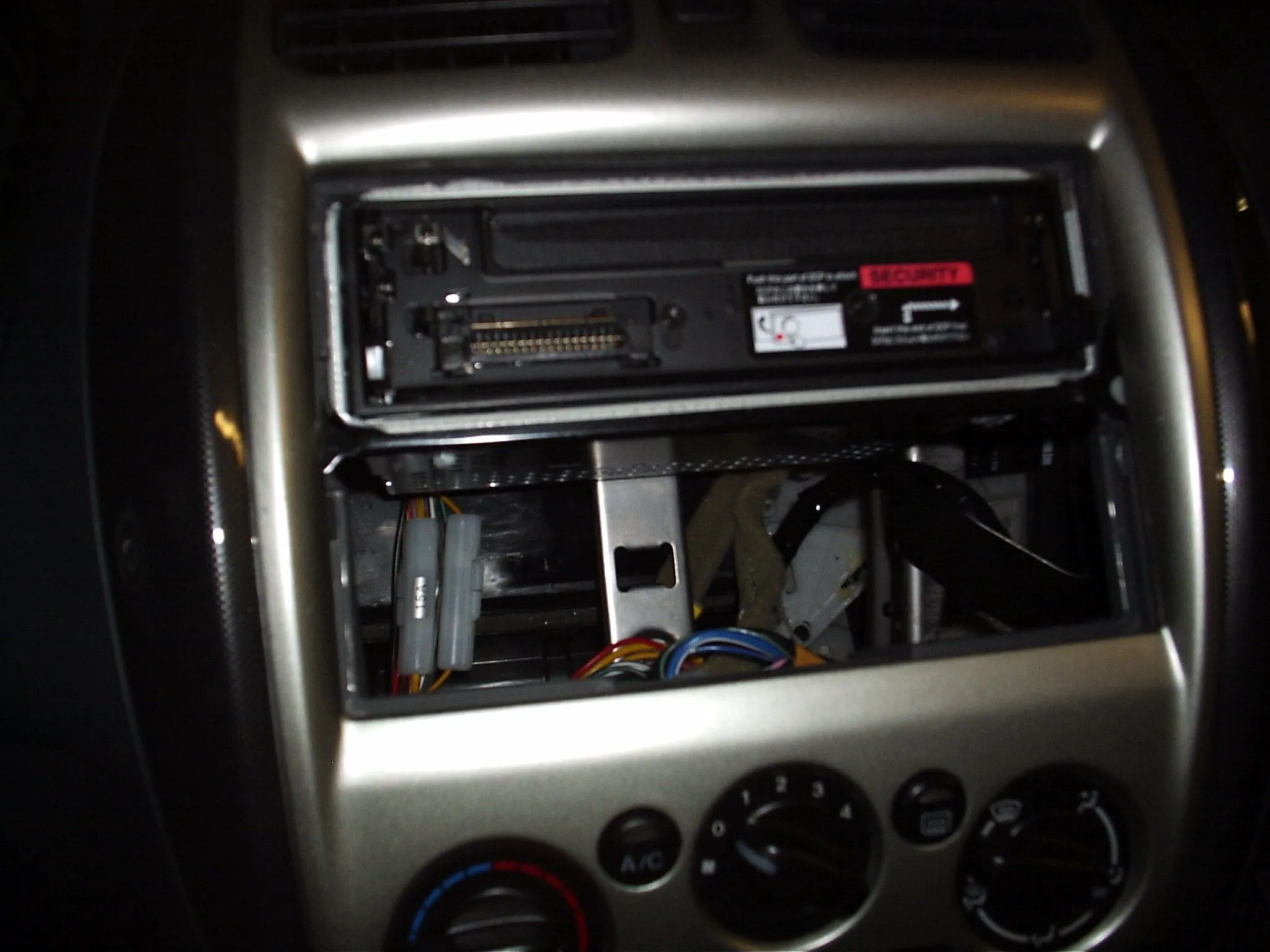

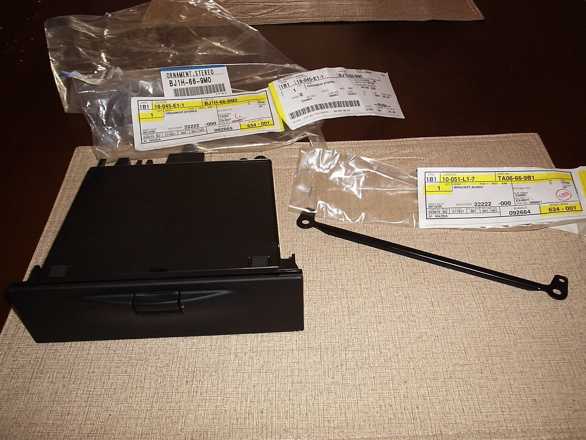

I got tired of the "ghetto" look of the Scosche Dash kit and the constant rattling from the Single Din Head unit. The part numbers needed for this install are TA06-66-9B1 Bracket and BJ1H-66-9M0 Radio Pocket (Pic1). Also need 2 small plastic nuts and bolts. The Bracket does not come with the nuts and bolts so I bought them from Home depot. I chose the plastic/ nylon bolts since it is hard to push them into place and the plastic ones are less likely to scratch the painted metallic surface of the dash. Total time taken 30 mins.

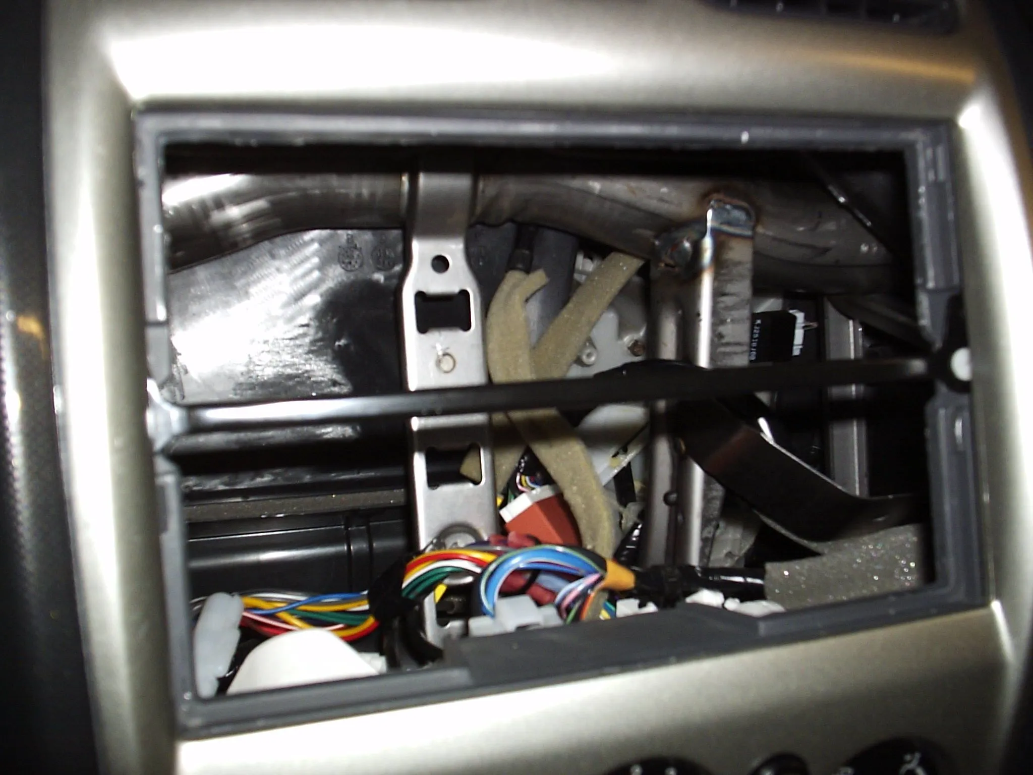

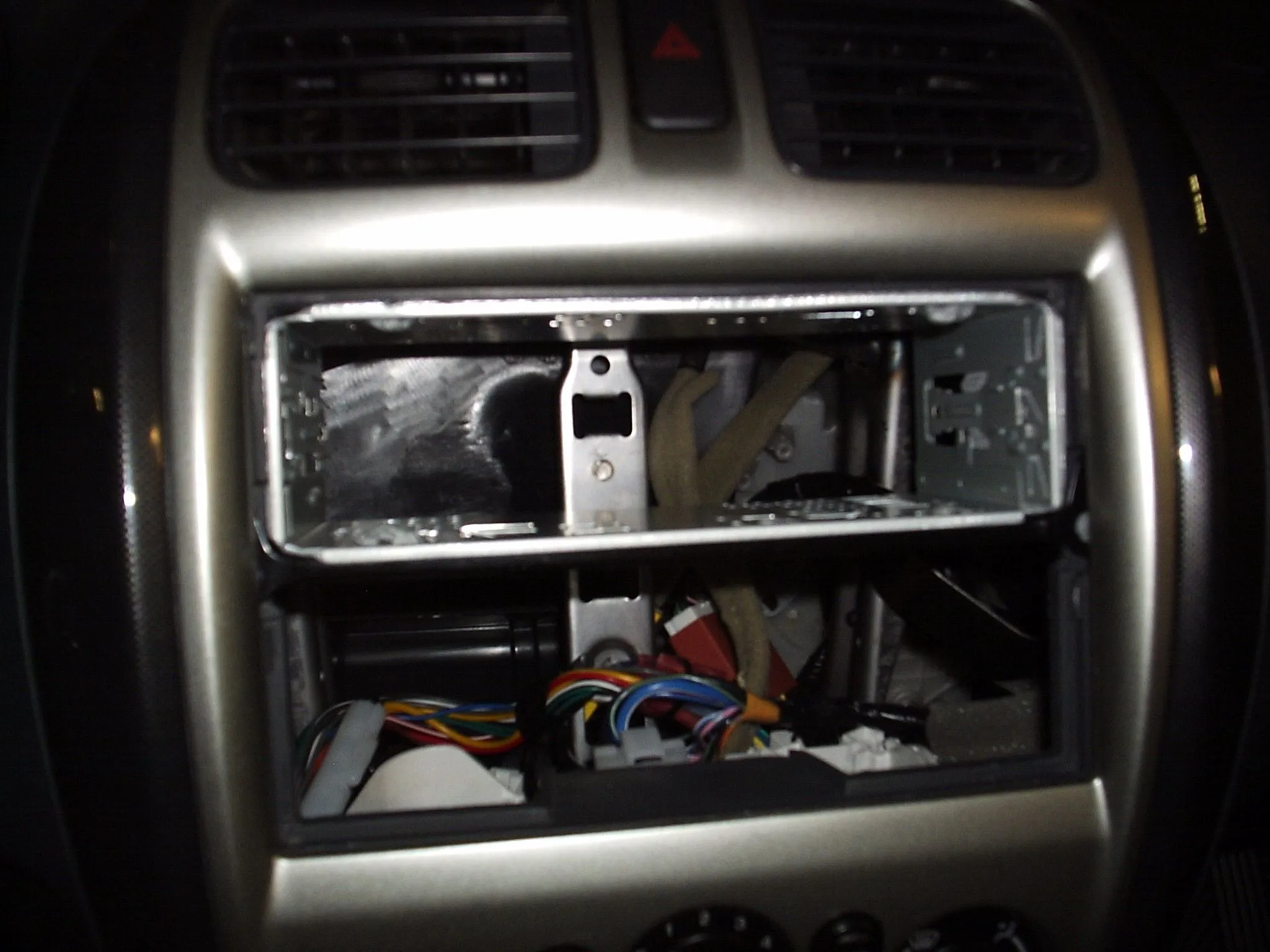

1. Remove the stock radio or remove the Dash Kit. The Scosche just pulls out. I found it easier to remove the metal sleeve from the dash kit and then gently prying it out in order not to scratch the dash. To remove the metal sleeve for the head unit, gently pull down the tabs with a small screwdriver. (Pic2)

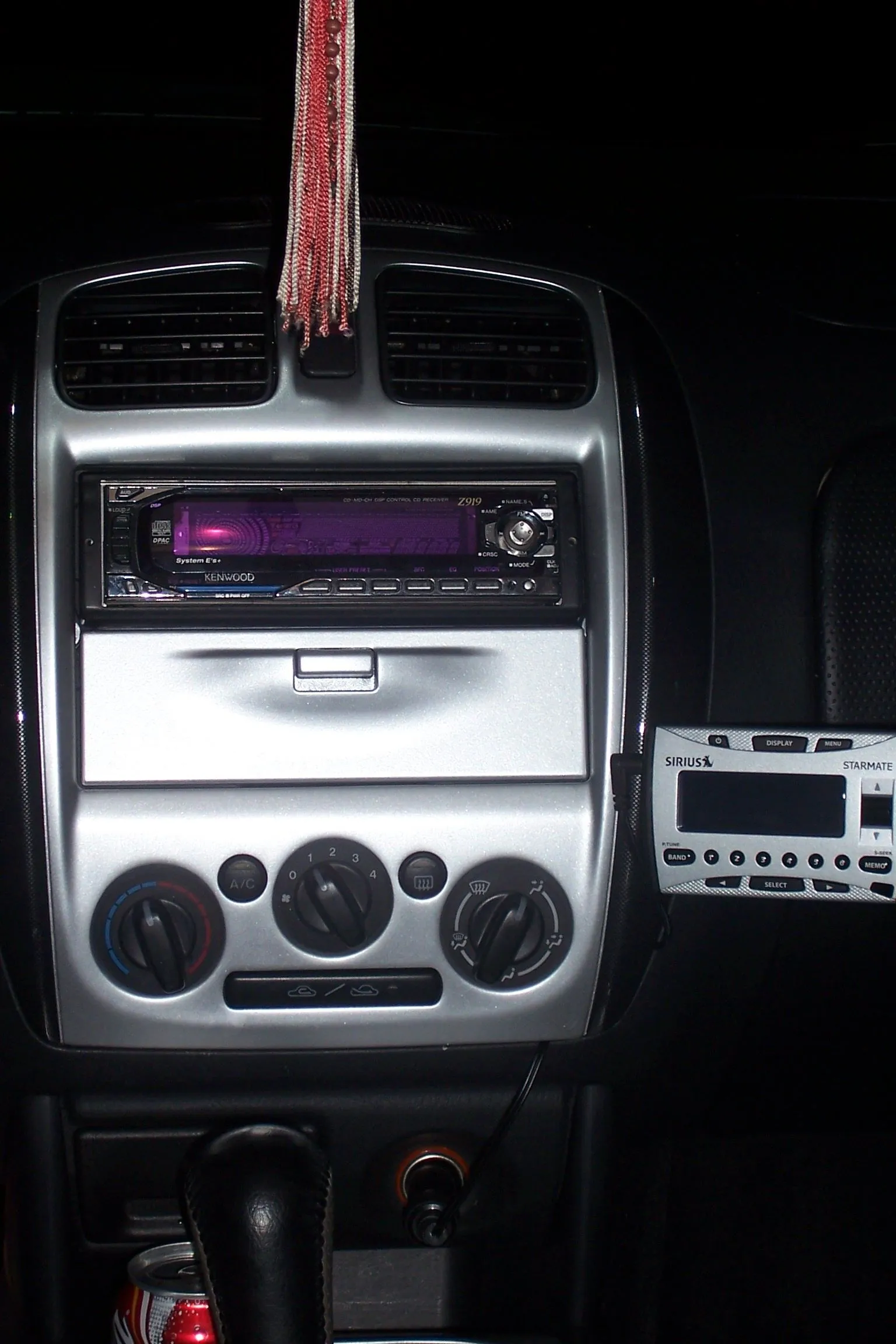

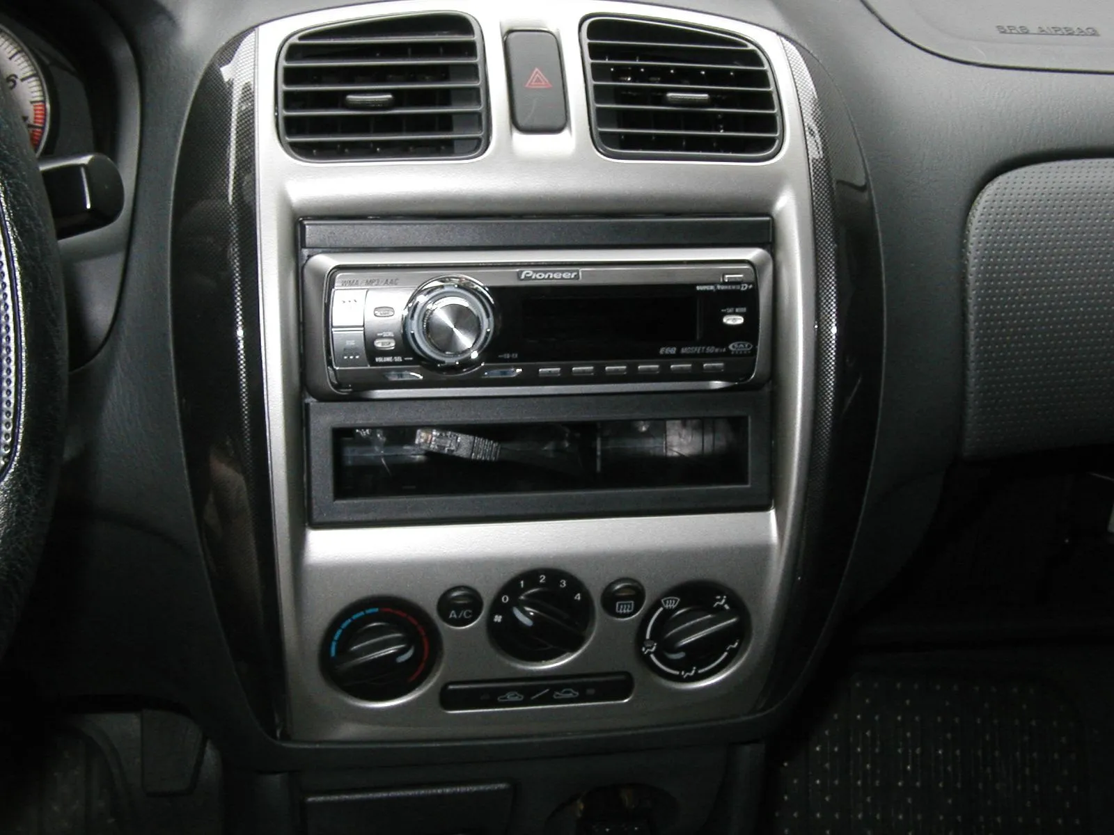

2. The bracket goes face up into the pre-drilled holes in the dash. Careful not to scratch the metal trim. The bracket's upper holes will fit into the tabs above the hole. Gently insert the small bolts into the hole and secure with the nuts. (Pic3).

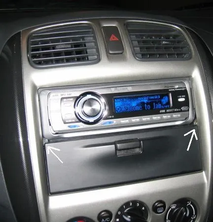

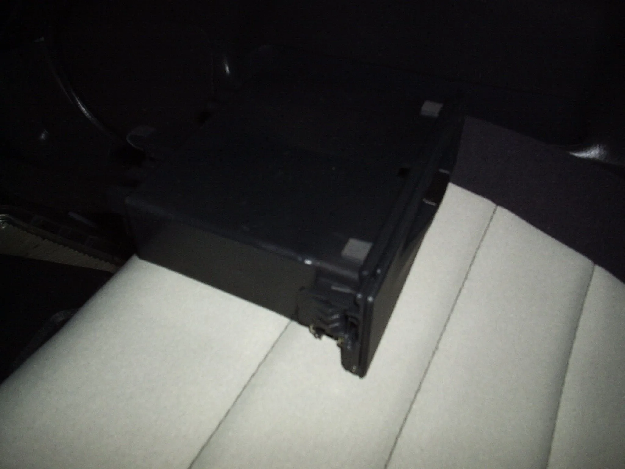

3. Insert the metal bracket (comes with the head unit) into the upper slot and secure by pushing the tabs. Ensure this does not move. (Pic4)

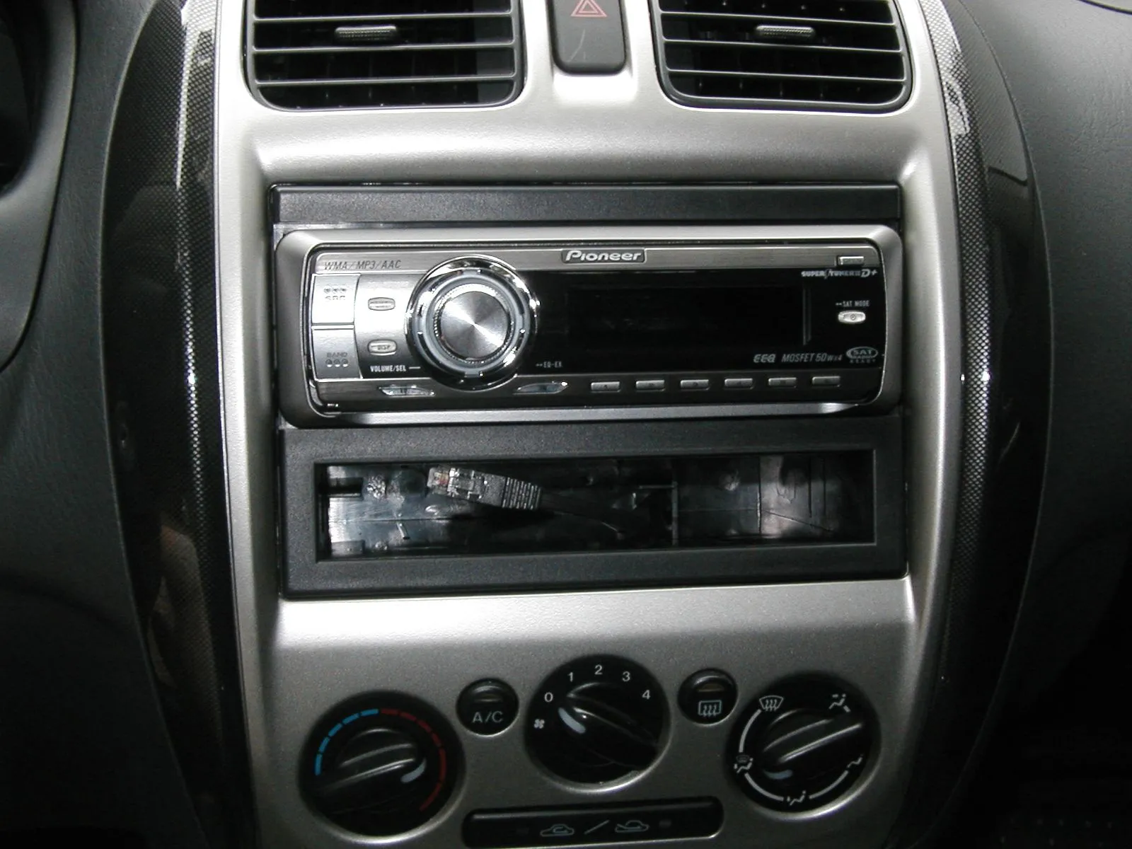

4. Connect the wire harness (and antenna) and insert the head unit into the sleeve, making sure the tab at the back slides into the hole in the metal bracket at the back of the opening. (Pic5)

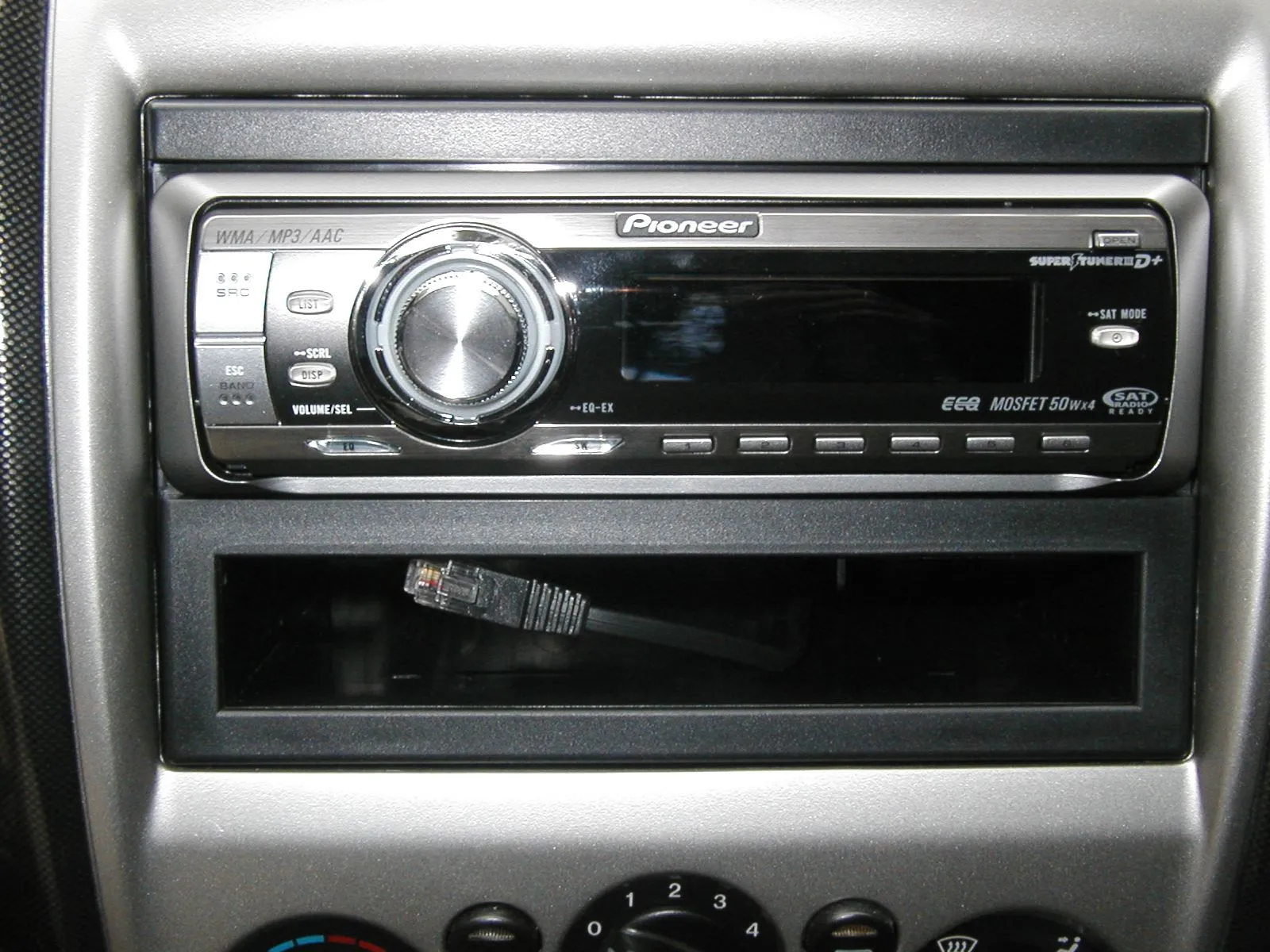

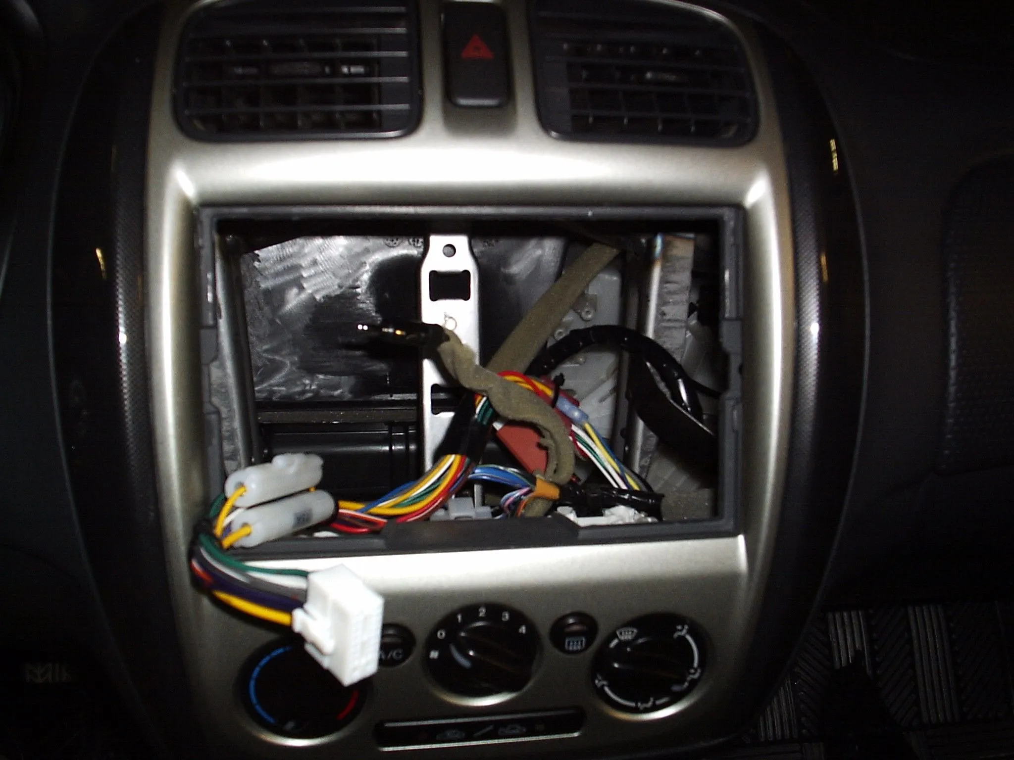

5. Slide in the Radio Pocket, it has a couple of tabs on each side to secure it to the dash and also locks into the rear bracket. (Pic6)
