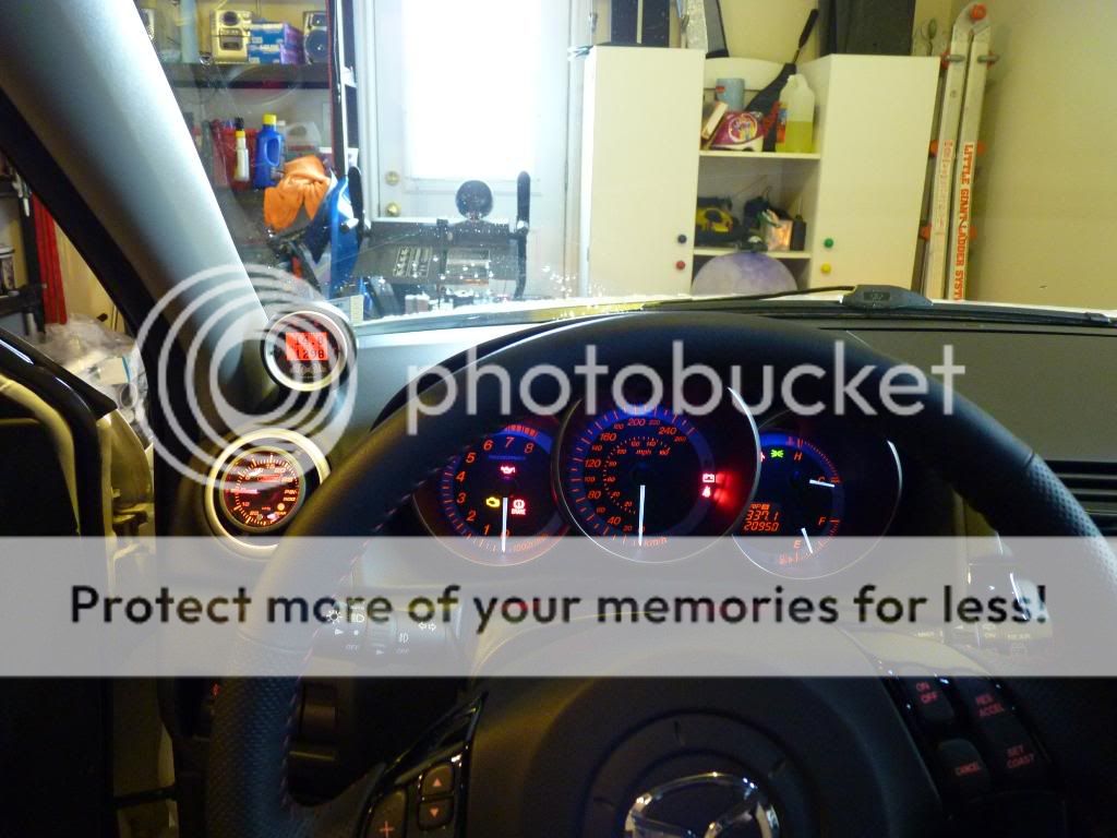

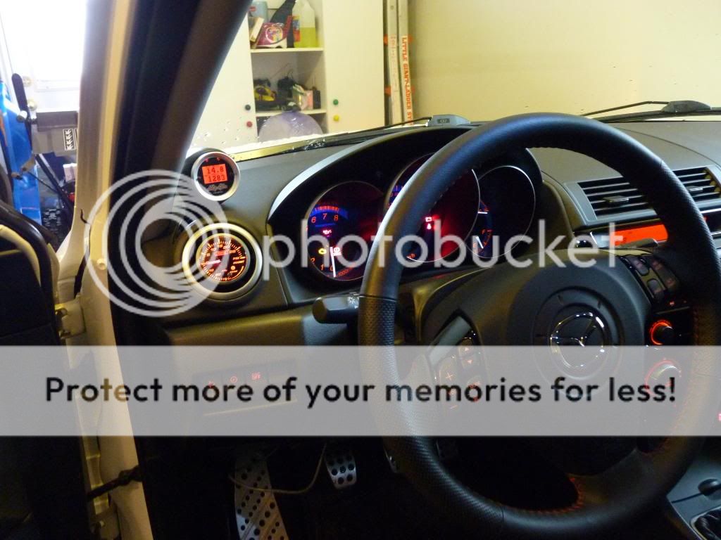

I'm not very good with the write up, so just follow the pics to your success.. (wink)
Remove this dash piece by using other steps...
To remove the pille you have to push it towrd the roof to unlock those clips behind the pillar...
you can be able to remove this screw from the round vent below..,simply remove the bottom vent to gain access...
There might be few missing steps ,but i'm sure you be able to figure it out...
One you done,put everything back in reverse order..
And here what is gonna look like when its done..:
Enjoy..

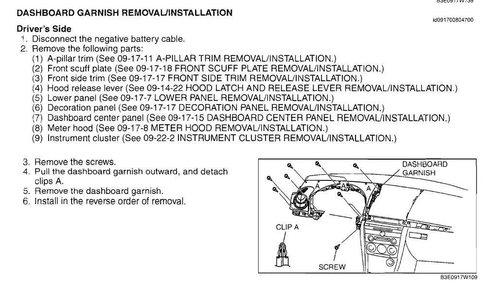

Thought this might help with the first piece to remove:

block8head made them from his own establishment. There was a GB for them last year sometime. Glad i got mine. This is quite possibly the best single pod for the MS3. PITA to install though with the disassembly of the ENTIRE dash. But worth it nonetheless.

Just got it all put in last night. Looks good, fitment is great. Thanks!
