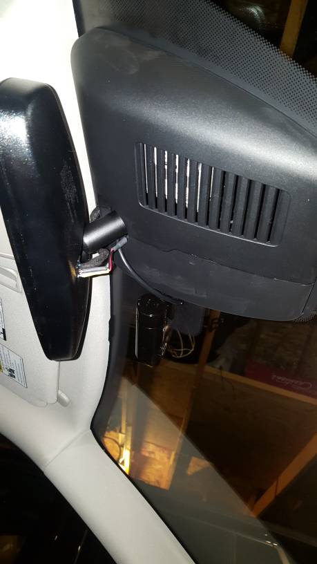

Here you go. Wish the USB input was on the other side but that small wire doesn't bother me at all. Barely see it.
Aye that’s neat enough. Nice job.
How did you run the wire?
Ran it to my homelink mirror via the invisicord. I also added a 90 degree micro USB adapter because the OEM power adapter stuck out way too much. I can post that adapter and a better picture for you if you'd like when I get home.

Yeah worked out well. Love that it all turns on and off automatically too.

Yeah paint a link to that adaptor would be much appreciated. I would imagine the invisicord will be compatible with many different dash cams? I haven't settled on the exact brand/model I'm getting. Also if you can direct me to a set of instructions that would be great

Okay so the inivisord is the main cord that allows for power. There are different power hooks up for the invisicord but I got the micro usb option because my garmin dash cam is charged via micro usb. The invisicord is posted within this forum.
Here is the 90 degree micro usb adapter https://www.amazon.com/dp/ (commissions earned).

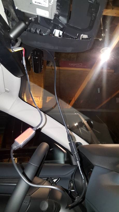

Here is a picture of everything tucked up and connected. You can't see anything from normal driving positions.
So basically 90 degree micro usb adapter, plugs into the micro usb invisicord, and that just plugs into the homelink. Which is the red and yellow wire you see. Those insert locations are also posted within this thread.

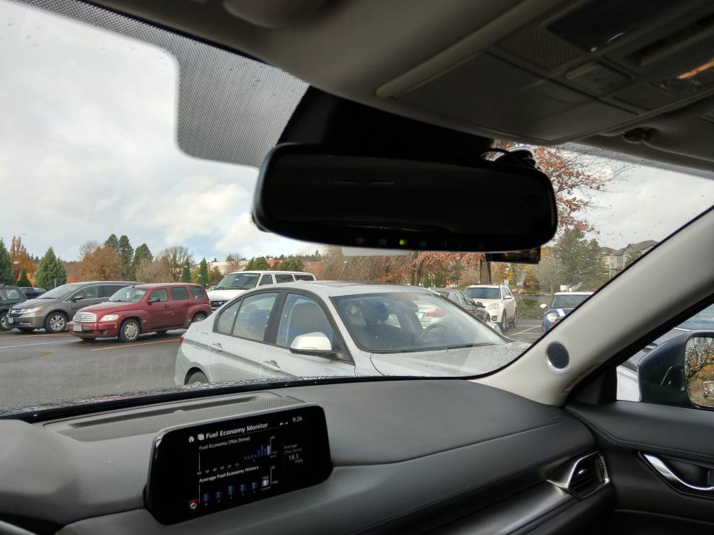

I have installed my Mini0805, as the first picture. I can't even see it. I have the same 90 degree USB adapter and I have soldered the wires, to the mirror connector. I have a 12v to 5V adaptor, tucked up over the sunglass holder.

Installed a ddpai mini 2 in the 17 cx-5 tonight.
Here's a during and after shot of the wires.
