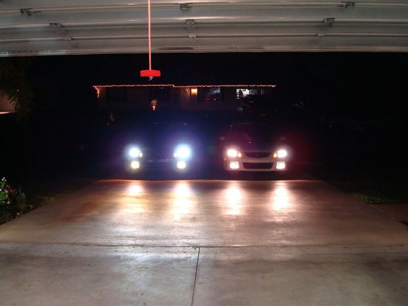

your H7 HID kit you have now will pop right into the stock low beam location. And, i know our cars aren't made for HID's, the stock beam is quite good. Here's a pic I snapped of a 4300K kit in my low beams

Hey Tylor, is that what you are running now? That's a lot of illumination man. Are people flashing you back? I can see the stop sign is fully illuminated, and that's your low beam.
Yeah, that's my setup now. Apexcone 4300K HID in the low. I have lowered them just a tad after that shot was taken, but, no, no flahses at all. I had my wife run around in front of me in her car and the only difference she could tell compared to other car is the color. Everything else looks yellow in comparison.

Pics like this these. The headlights in mine were still just a little too high, they have been lowered.
Also, there are 3 dif. bulbs in these pics.
My car has the Apexcone 35watt HID kit, passenger side of wife's Pro5 has Stockers, and driver's side is SilverStar Ultras
