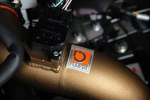

what is that exactly? any pictures or links of it?
It's a sensor. that meters/measures the air that's making it's way into the engine. It sense all kinds of stuff such as how dense, temps, volume, velocity, etc.
Here's a pic of one.

I bought one hoping it would get rid of my boost cut...it didn't, but it did fix my fuel trims nicely!! And smoothed out my MAF readings at high RPMs.
