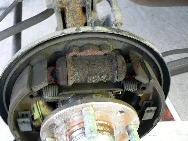

I noticed tonight that the piece at the top of the drum brake that touches the top of both brake shoes can be adjusted. It has black rubber at on each side, connected to a metal piece that looks like a flathead screw but bigger. I think it goes smaller if you twist it clockwise with a pair of pliers. Im pretty sure you adjust that, and then pull the ebrake which will readjust by itself.
Hah I guess those screws really arent important at all! The cover IS mounted on the lugs.
