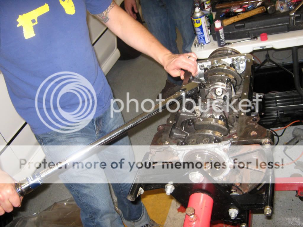

Installing Oil Pump, Crank and Output Seals
Output seals are easy, you will figure it out.
Crank: Invert the engine and blast the mains with WD-40, Place half the bearings in their correct location (x5) place assembly lube and then place the crank in place.
Put the other bearings in the main caps and lube them.
Place them over the crank, but do not force them down. Install the mains bolts (I had ARP Studs for this and they torque in three stages, 40, 50, then 60 in a star pattern.
Oil pump should be primed with motor oil, pour oil in and rotate the gears. Make sure that the O-Ring is installed and seal it to the block with Grey Silicone.

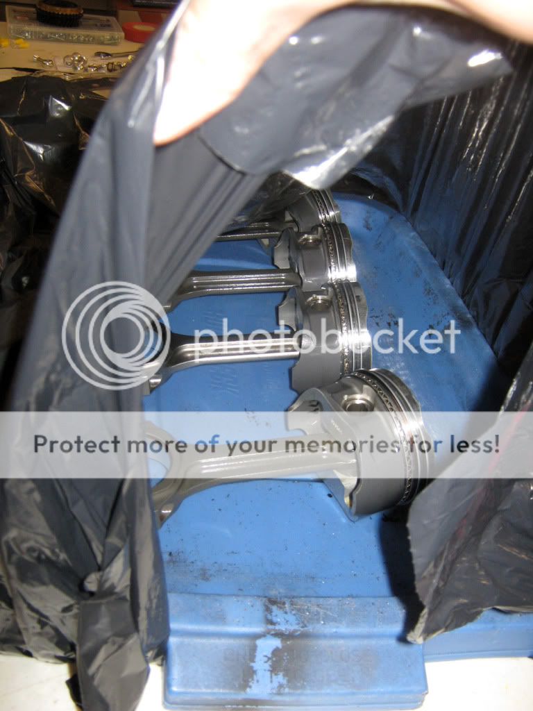

Installing Pistons and Rods
<LI class=remove>-
<LI class=add>+
<LI class=remove>-
<LI class=add>+
The pistons and Rings should be assembled by a person who has done it before.
The pistons should be installed in pairs only, The two outside at once or the two inside at once.
<LI class=remove>-
Make sure that the piston is able to easily slide in with several small taps, rather than one big one.
Before the rod makes contact with the crank, install the rod bearings. Clean them with WD-40, then put assembly lube on the crank. Push the piston in by hand until it seats on the crank. Put the second part of the bearing in the rod cap and lightly screw in the bolts on the cap, just to hold stuff in place. Repeat this for the second piston.
If it is an APR bolt, there is Torque Grease that must be applied to the bolt to give consistent results.
My Pauter Rods came with a 50 Ft Lb torque requirement and a 12 Point bolt head.
I suggest first torquing to 40 then to 50.
Once the two are torqued, you can spin the crank to make sure there is no binding. It is normal for this to feel seized. Even with the lube on the cylinder walls, you are literally polishing the rough surface of the cylinder, and all the bearings by hand.

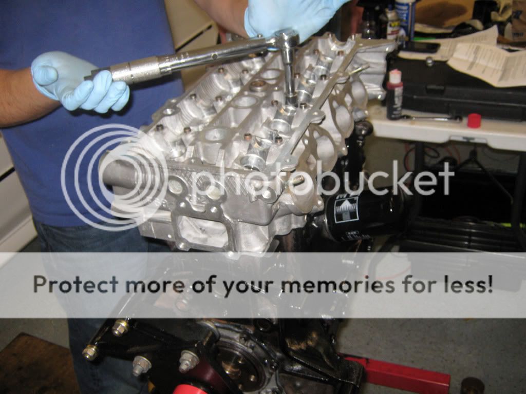

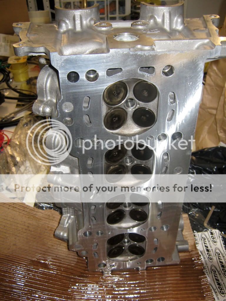

Installing Head Gasket and Head Bolts
DO NOT REUSE THE OEM BOLTS.
MAKE SURE THE BLOCK AND HEAD ARE MACHINED TRUE AND FREE OF OIL/CRAP
MAKE SURE THE HEAD GASKET IS FACING THE CORRECT WAY
DO NOT DROP THE HEAD SHARPLY ON THE GASKET, IT WILL CRUSH THE GASKET
<LI class=remove>-
<LI class=add>+
<LI class=remove>-
<LI class=add>+

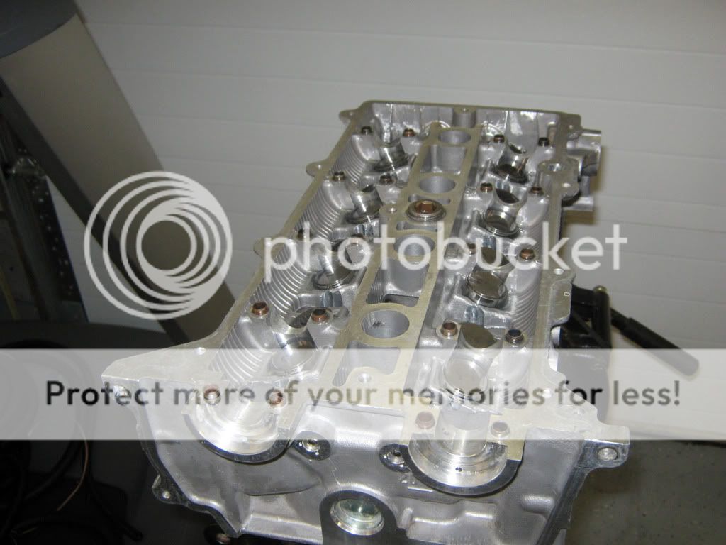

Cylinder Head Installation Note
1. BUY NEW BOLTS FROM DEALER YOU CHEAP BASTARD (I don't give a s*** what others tell you to do, they are Torque Yield Bolts, meaning they behave like a spring.
Standard length<LI class=remove>-
<LI class=add>+

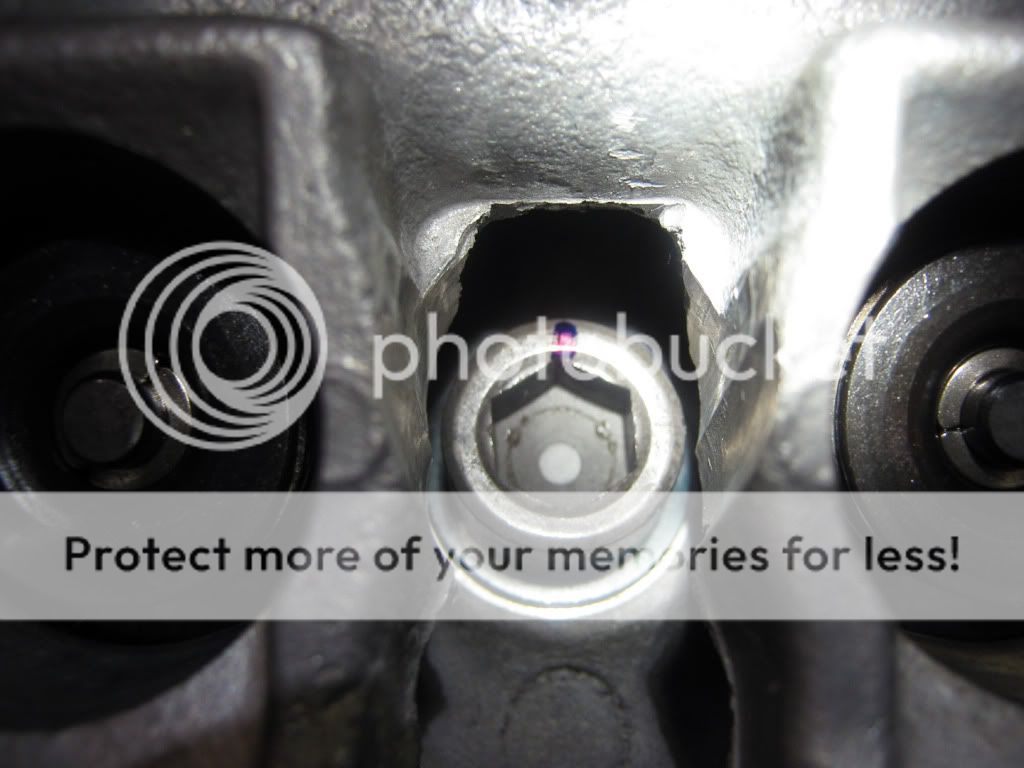

Tightening torque, NOTE THAT THIS IS A VERY TINY NUMBER, use a 10mm Allen Socket and as short of an extension as possible. The extension will make the torque wrench read LOWER than actual, use the higher 16.5 Foot pounds value. I had to convert it to Inch Ounces as that is what my small torque wrench is scaled in.
<LI class=remove>-
After you have torqued all 10 bolts in the proper sequence, you should verify the torque making sure not to over torque.
<LI class=remove>-
<LI class=add>+
Get a Paint marker and precisely mark the 12 O'Clock position on all 10 bolts and let it dry for 10 min.
You should have a second person help steady the engine for the next part as it requires a fair bit of force.
With the Paint mark as a reference, Starting From 1 to 10 like before apply 90 Degrees to each bolt.
Once you have done all 10, then
Apply a second 90 Degrees to each bolt. (You Will Feel As If You Will Break The Bolt, You must apply the full 90 Degrees.)
Once done, all marks will be 180 Degrees from where they were painted, or 6 O'Clock.

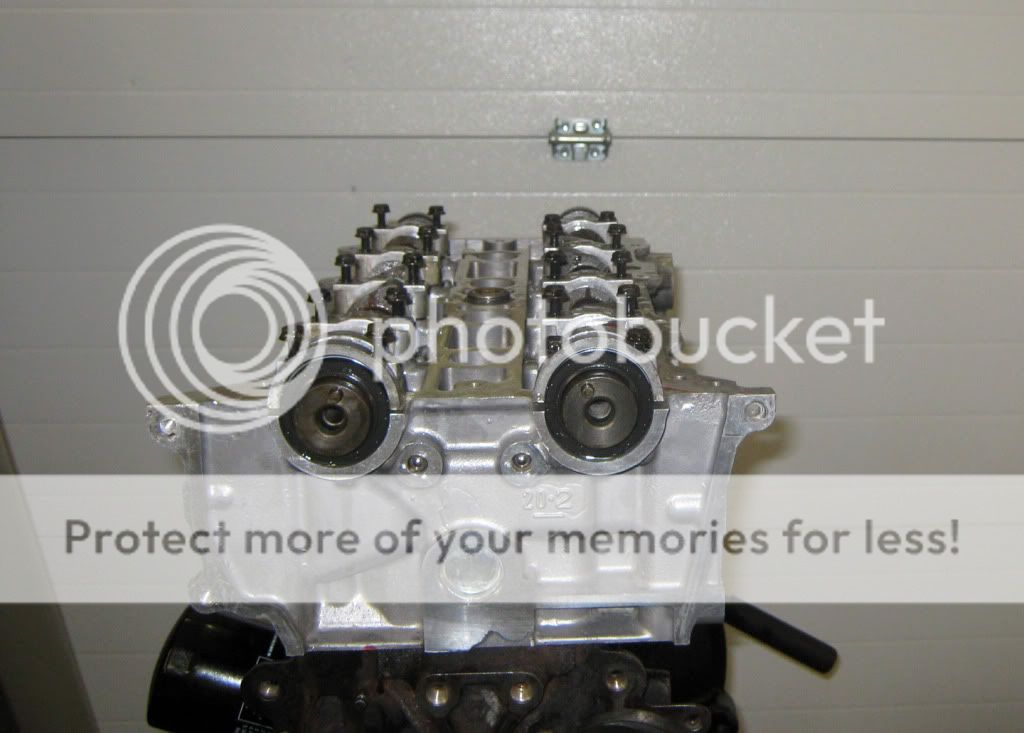

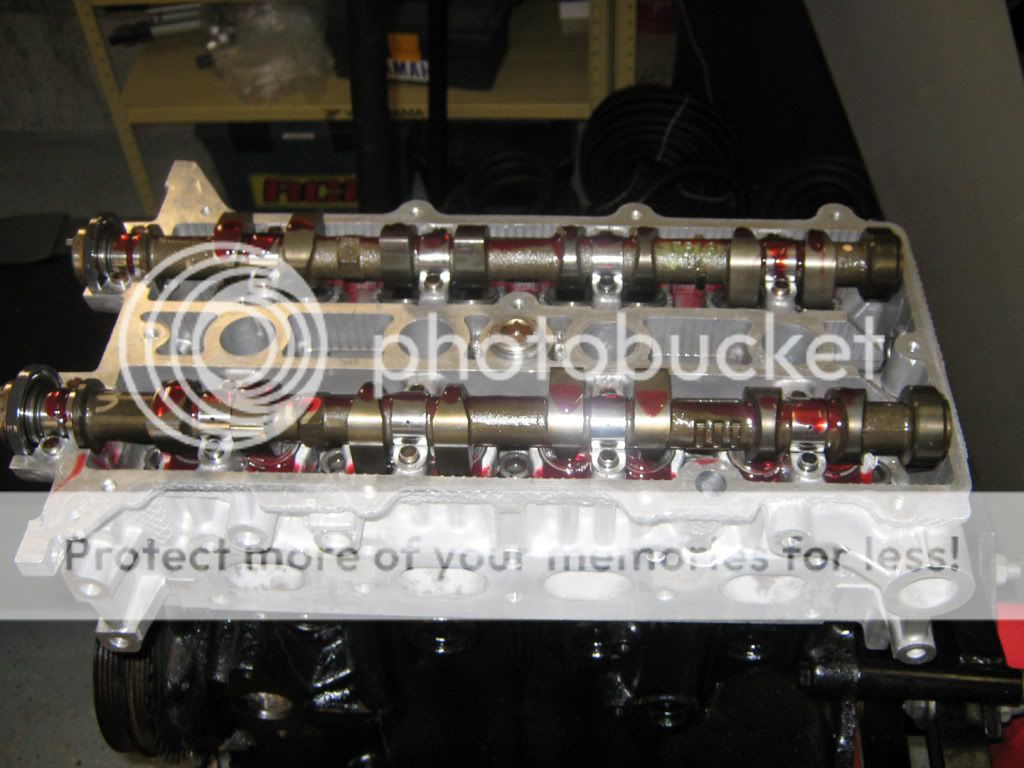

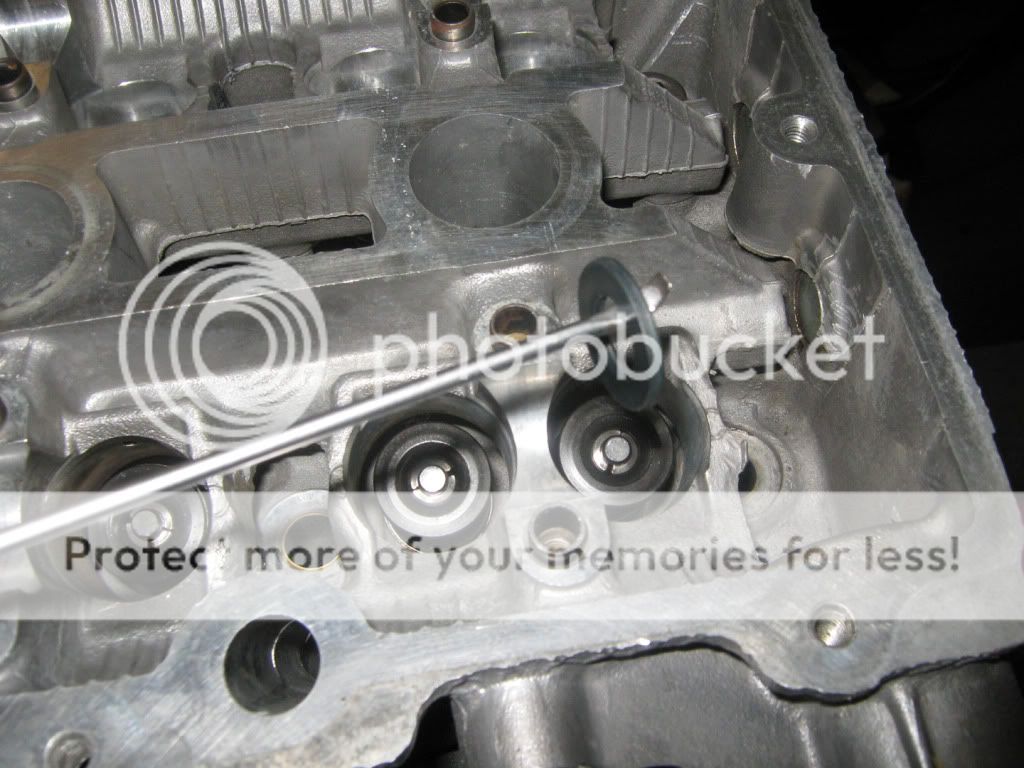

Installing Cams
<LI class=remove>-
<LI class=add>+
<LI class=remove>-
<LI class=add>+
<LI class=remove>-
<LI class=add>+

HEAD SURFACE
More important than the Deck.
NOTE: The head has three wear marks, They work like a wear mark on a tire.
If the machining that must be done, goes down to that point, then the head is GARBAGE. The piston could hit the top of the head and totally damage the entire motor. Get a new head and rebuild it.
Same as before, a big blast of brake cleaner, and a heat gun, just before being placed over the head gasket.
Standard length
104.2104.8 mm {4.1034.125 in}
<LI class=add>+104.2104.8 mm {4.1034.125 in}
Maximum length
105.5 mm {4.153 in}
2. Tighten the cylinder head bolts from center out in a star pattern. This is so that the gasket is able to lie completely flat and not bunch up during the install..
<LI class=remove>-105.5 mm {4.153 in}
17.522.5 Nm 1.792.29 kgfm,
From 13.0 Foot Pound To 16.5 Foot Pound
<LI class=add>+From 13.0 Foot Pound To 16.5 Foot Pound
