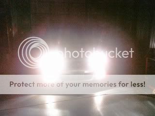

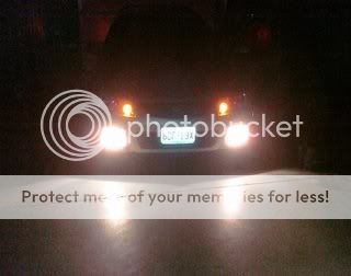

Here is my pictures after I did the "mod"....
w/highbeams
