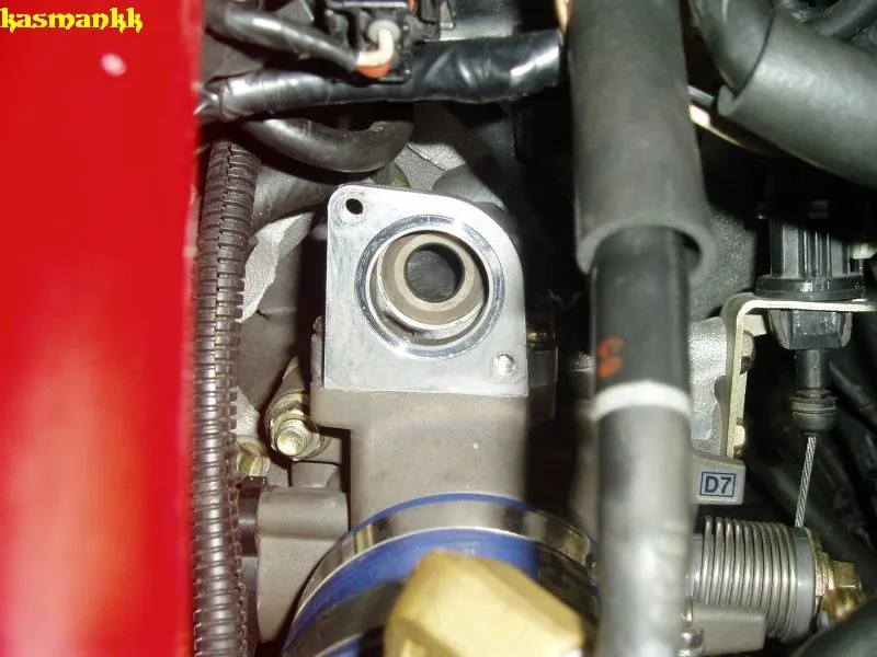

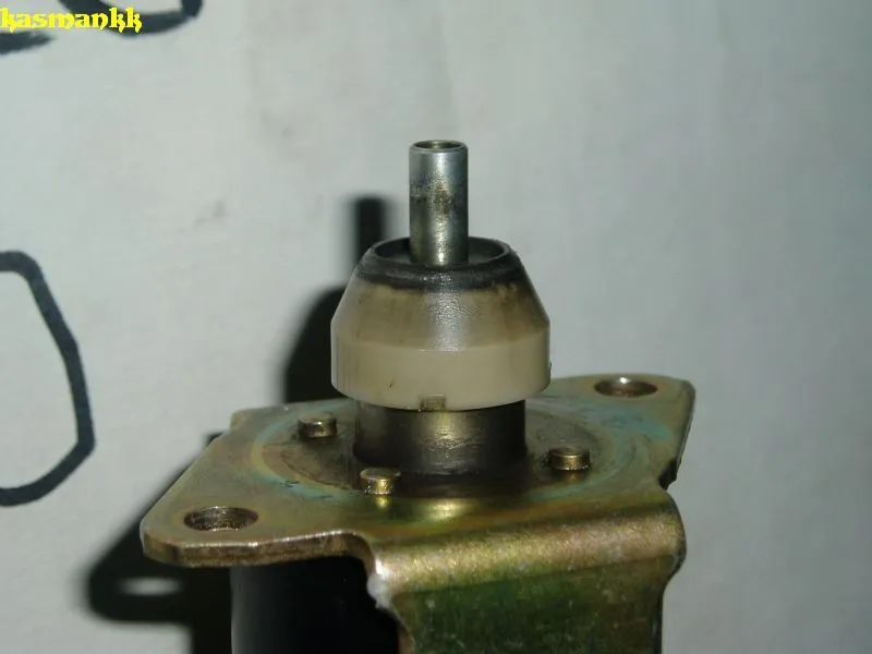

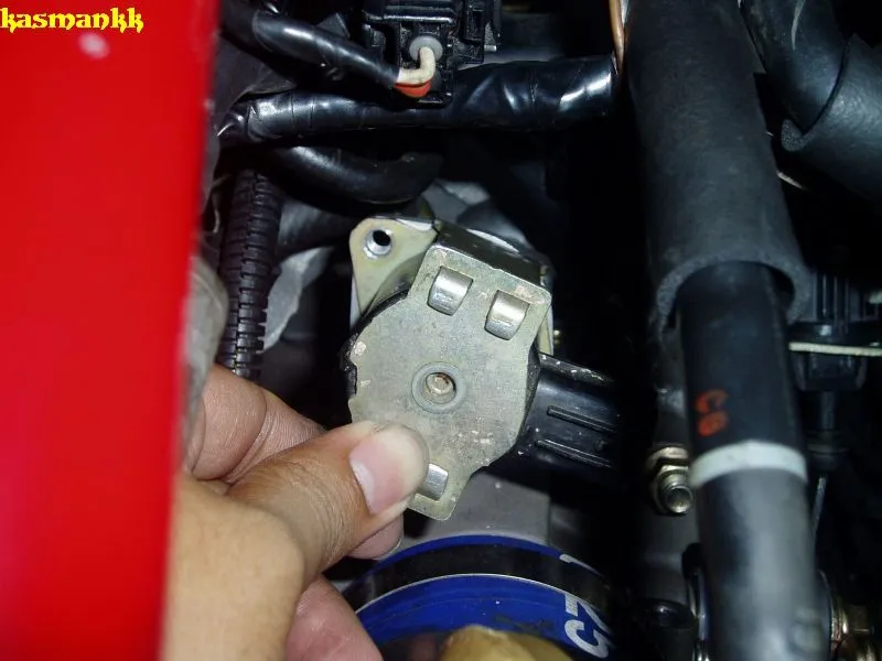

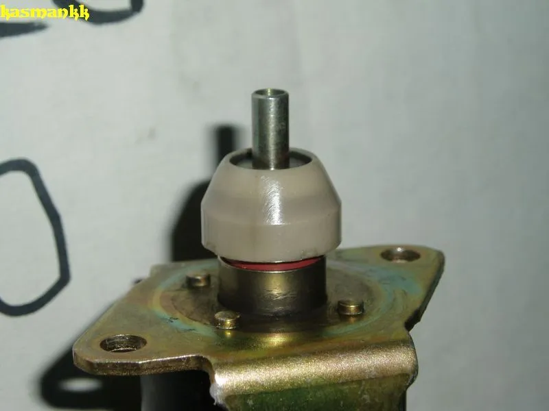

check out the pics. In my case, when i removed the solenoid valve, the plunger got stock to the throttle body. There was carbon build up.
