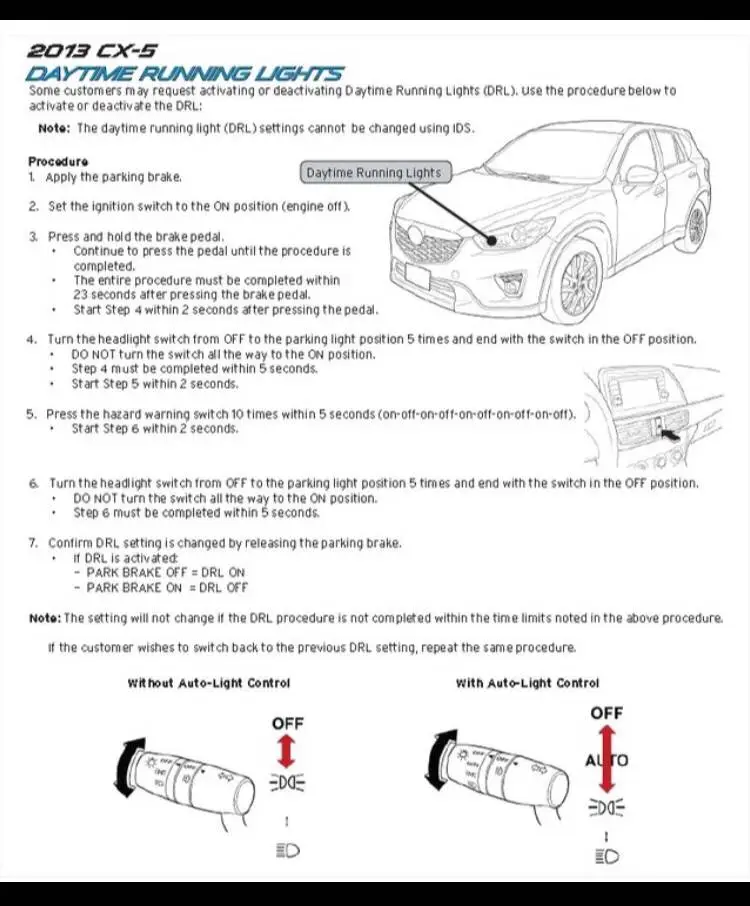

If you’re saying the headlights are always on on US models, then what do you mean by “let us know if the procedure still works on 2022”? I live in the US and it worked perfectly on my 2017 to only show the thin daytime running lights (and the taillights) when I had it set to parking lights.
Because some newer MY (2021?) CX-5 owners reported problem to turn off DRLs by following the instruction presented here. And Mazda did some changes to the headlight unit on 2022 MY CX-5, it’s possible Mazda also made some changes on DRL setup controls for North American or US market.
What do you mean by “video game trick”? Does that mean turning the light switch to “parking light position”?
This:
I called a dealer in my area and the head technician looked it up in his computer and saw that the cheat code can be done for 2022 also. Why the default factory setting for daytime running lights isn’t just the accent lights on the front of the car is a mystery to me. Literally every other car manufacturer has just accent lights lit when headlights are off. At least Mazda does have the cheat code that gives you full control of the light knob inside the car. I guess I’ll find out for sure when I do the cheat code or I have the dealership do the cheat code on my 2022 Premium.

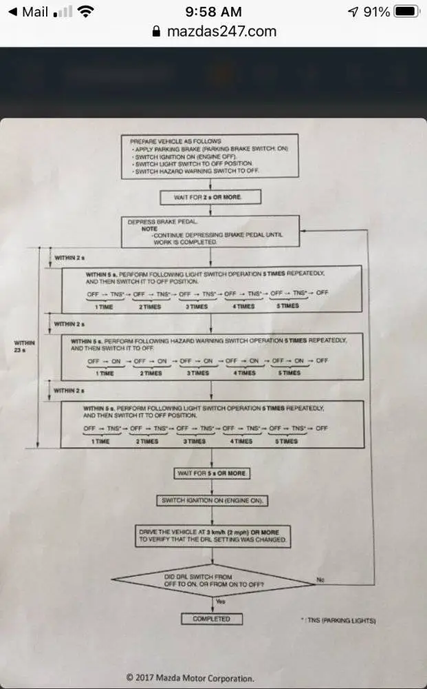

Has anyone confirmed firsthand that it works for the 2022s? I've tried on my wife's car over and over and it doesn't seem to work.
A technician told me it works the same on 2022s. Maybe you can explain how you’re doing it.

The instructions don’t remove the daytime running lights altogether. They remove the headlights from the daytime running lights setup, So only the thin halo lights are on unless you have the headlight switch turned to off, on and maybe auto. I know only the thin lights will be on if parking lights are on; I’m not sure about auto setting. And no lights will be on at all with the headlight switch turned to off.
When you say “no lights will be on at all with the headlight switch turned to off”, this means the DRL function has been removed altogether. The LED accent strips / thin halo lights are part of parking lights which will be on when the parking lights or headlights are on, either via Auto or manual.
Reading this thread it looks like many people miss some minor point and the procedure fails. I did it on mine, wasn't sure if it worked and did it several times to verify and reverse it. The parking brake light is supposed to indicate the function.
