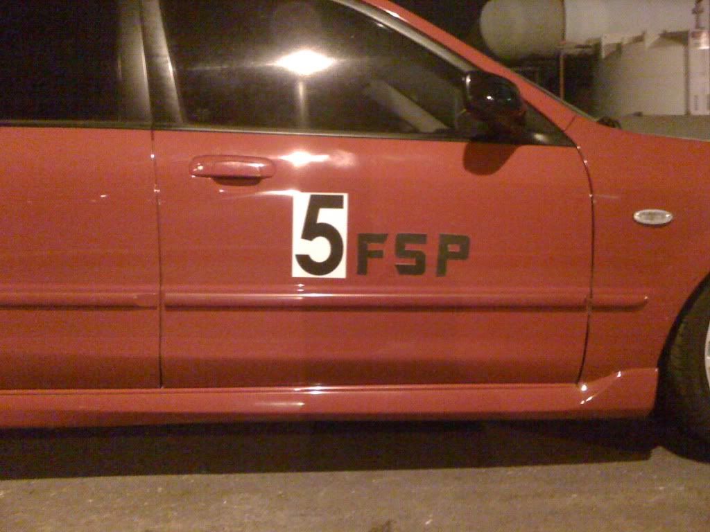

As for the sizes for the letters the size is 400 you can fit up to two letters on each page. So if you are *SP you would want to spread it out so that two letters fit on a page. (like so)
As for the numbers you will have to go with 800. Go into the page setup and set all the margins at 0 or else the numbers will not fit onto the page.
Once you have them printed out you can cut them up and they should be ready to rock.
