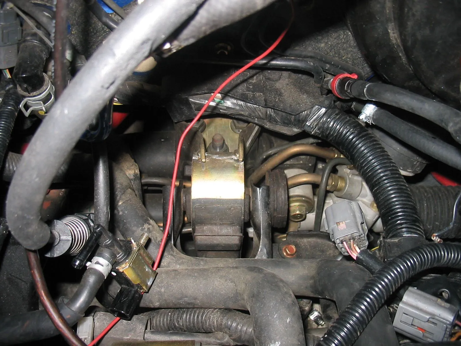

I would have to agree with gar777 about stressing the rear mount. Heres a pic of my rear engine mount, found it with a big rip in the metal when I went to put the head back on today

A.V.MSP said:
I would have to agree with gar777, heres a pic of my rear engine mount, found it when I went to put the head back on today
Thanks for the pic, it's a great start! Anyone else have any more??
could you clarify what happened? did you have the awr front mount and the stock rear? that looks like the awr rear mount. how do you think it broke?
stock mounts all the way around. Dont really know how it happened. When I blew my head gasket it was fine, then I had to take the motor apart again because I had a low spot in the head and didnt know it even though I got it straight edged. Any way go to put it back together yesterday after getting my head port and polished and the manifold port matched and just before I go to put the head on im looking around the engine bay and see that.
