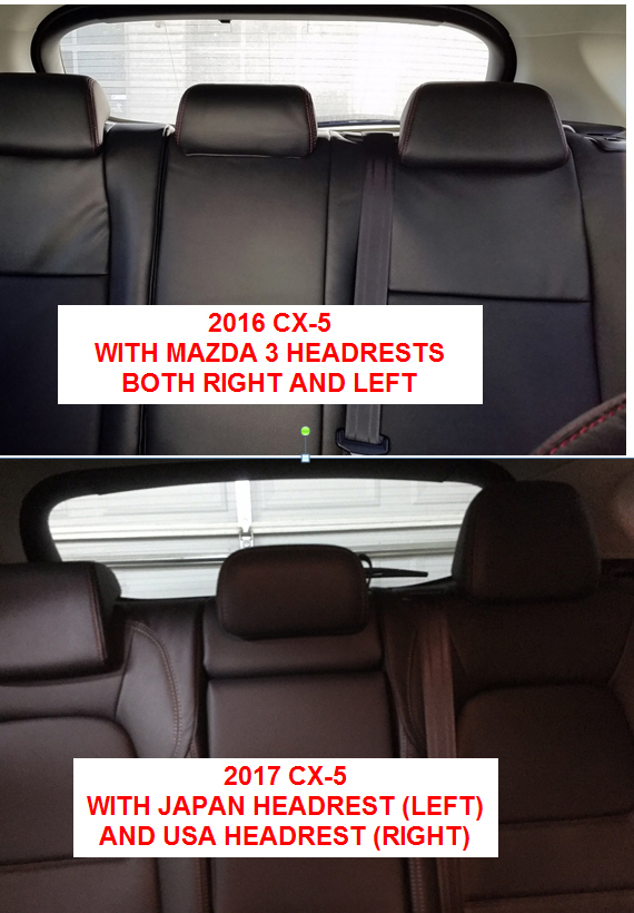

actually guys, not much difference that I can see, 2016 vs 2017, only thing is I see the 2017 rear wiper sticks up higher than previous, maybe it's just not all the way down....
and what's that loop on the center headrest for ? , last time I saw that was on the CX-9 where the seatbelt for the center passenger came from the ceiling down across the center passenger shoulders.
My wife says these make a huge difference.She is always right
