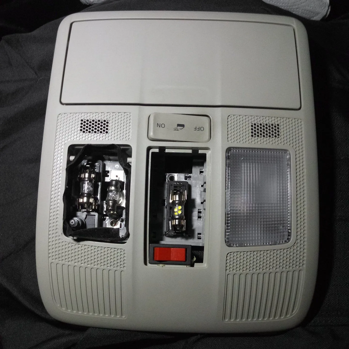

I added another LED to my overhead console (16.5 sport) in the center section where the sunroof switch section is. I removed the small panel and attached a socket.

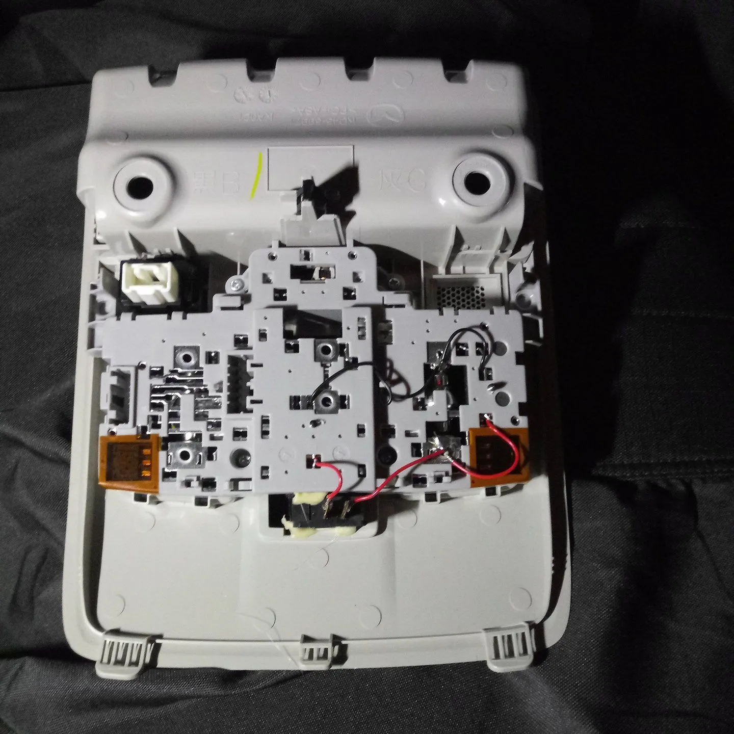

I used hot glue to attach a small switch and wired it to the passenger side map light. So I have to turn that light on to get the center light on.
The circuit board in the console has lots of (confusing) runs so I wonder if I can run the center light independently of the map lights?
In fact I would like to run it off of straight 12v unimpeded by the door switches.
