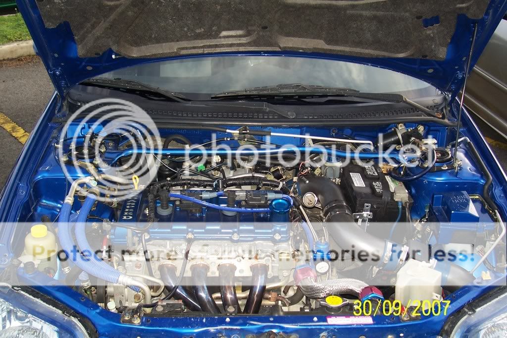

hey man thanks for our advice and its a 2.0!!!!!!!here is a recent pic
I Have Already Bought: Hks Ssqv, Tial 38mm Red Wg, Arp Head Studs, Act Clutch Kit, Aem Tru Boost Gauge And Controller, Aem Wideband, Obx Header And And A Precision Turbocharger!!!!!!
