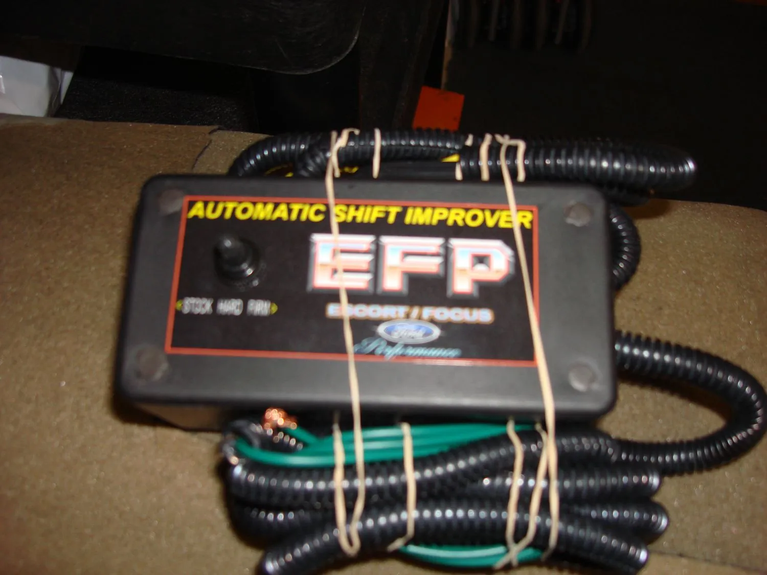

the one you got is wrong, thats the escort one, you need the focus one it has a knob you turn, not switch, I dont know if they are the same think the escort trans is different.
just checked--its my fault the link is bad in the post a few pages back, links to the escort one, http://www.escortfocus.com/html/shift_improver1.html
thats the one you need focus zetec.
that's funny because i thought there was no connection at all between escorts and proteges...hope they'll let me exchange it? i'm glad i posted that pic!
Lets make sure and get this clear.
The 4F27E was used on 00+ Foci (Focuses?) and Mazda renamed it the FN4A-EL and used it in the Protege, Mazda3,and Mazda6. They're not identical, but pretty darn close.
The Escort is something completely different.
he's right, and they're sending me out the new one once i return the escort one...
