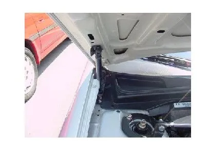

I've designed gas spring hood struts for cars I've owned....sponsered by a company called "Stabulis"..the lastest being my 2001 Honda Civic Coupe. I plan on designing my P5 as well, just haven't had time..Peace!
Here is a picture of that design

As a structural engineer, it is easy to just overlook the obvious and go get just any strut...but what many do not realize is the long term possible damage should the wrong gas spring and mounting brackets not be the proper materials and products once installed if you open and close your hood alot. The angle, newton loadings, gas spring quality, and length are all important. Now, no it isn't rocket science design work by no means, but if your not careful you can damage your hood. Our P5's are not to user friendly for this mod, as I already been scrathing my head. For one, there isn't a whole lot of room for the gas spring to compress and hide away properly. My designs are geared to look as OEM as possible too, which I've achieved for the most part. I'll take a harder look this weekend and see if I can design or start something...Peace!

The design for my 2001 civic was 300N each or about 68 pounds..where my civic's hood weight was about 25 pounds. It wasn't heavy at all. The gas springs are mounted at about a 45 degree angle for proper collapse. Our P5 hoods are very heavy, even in comparison to many vehicles. So assuming the approximately same mounting angle..a 60 pound gas spring will not work.......maybe something more like 75-100 pounds per spring...but I'll toy around with it as well and use some more parts given to me by the sponsered company..Peace!
