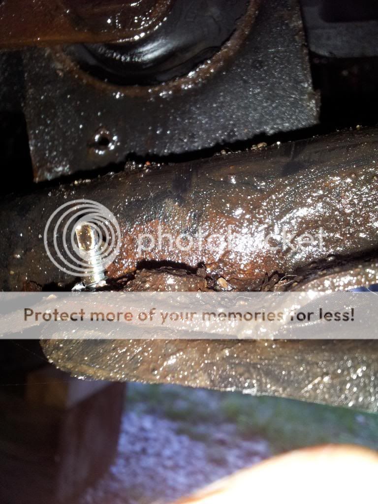

That's a chunk of rubber I jammed into the motor mount. It made a noticeable difference. Most productive twenty minutes I've spent on my car (next to the Colgate on my headlights)
I'm saving up my time effort and money for bigger things like when my ass falls through the floorboards,.. Almost every P5 around here is a rusty piece of crap,... Her glory days are over around here, it's kinda sad,... That was a quick and easy fix,.. no more engine flop.

It's pinched in there real good,... I put the jack on the stud and lifted the engine up to open the gap.
