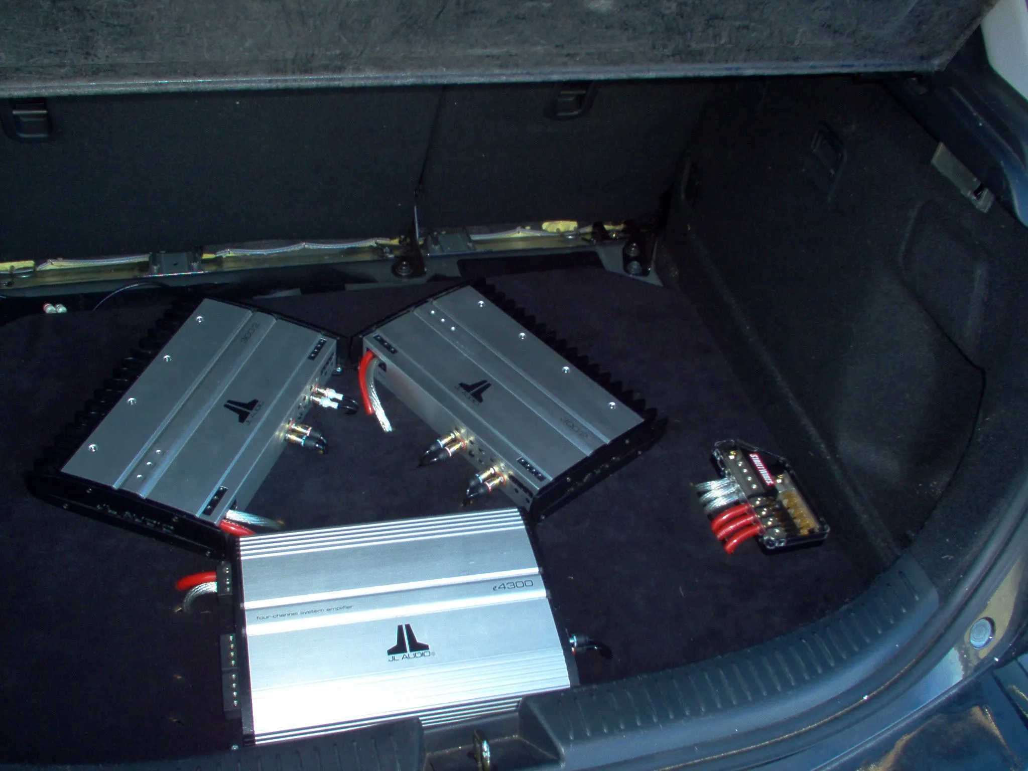

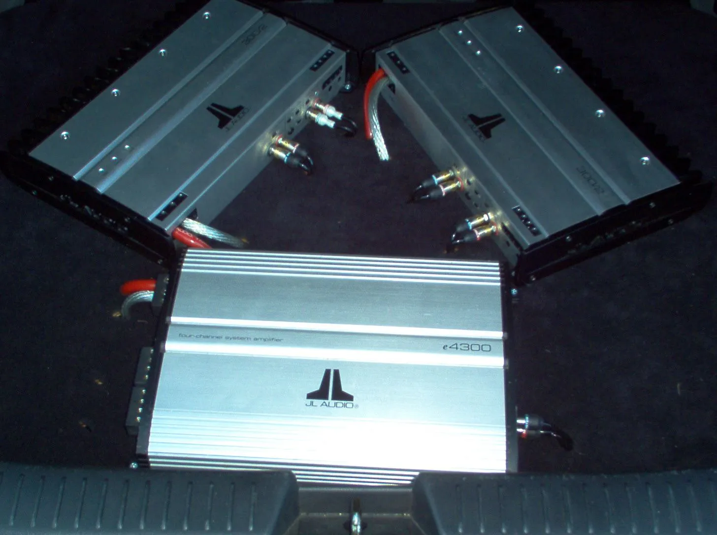

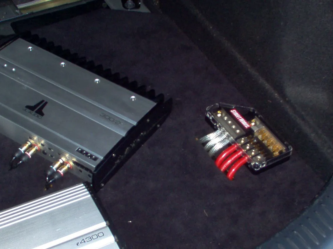

i made an amp rack and removed all those plastic cubbies above the spare tire... i can still get to my spare it will just take a few more minutes then normal is all... and you can run the wire under the plastic cladding and carpet....

TSUNAMI, ive always wanted to do something fancy with my amps and sub boxes but I need the cargo space...your setup looks good, id love to pop the hatch and have nicely displayed amps...
