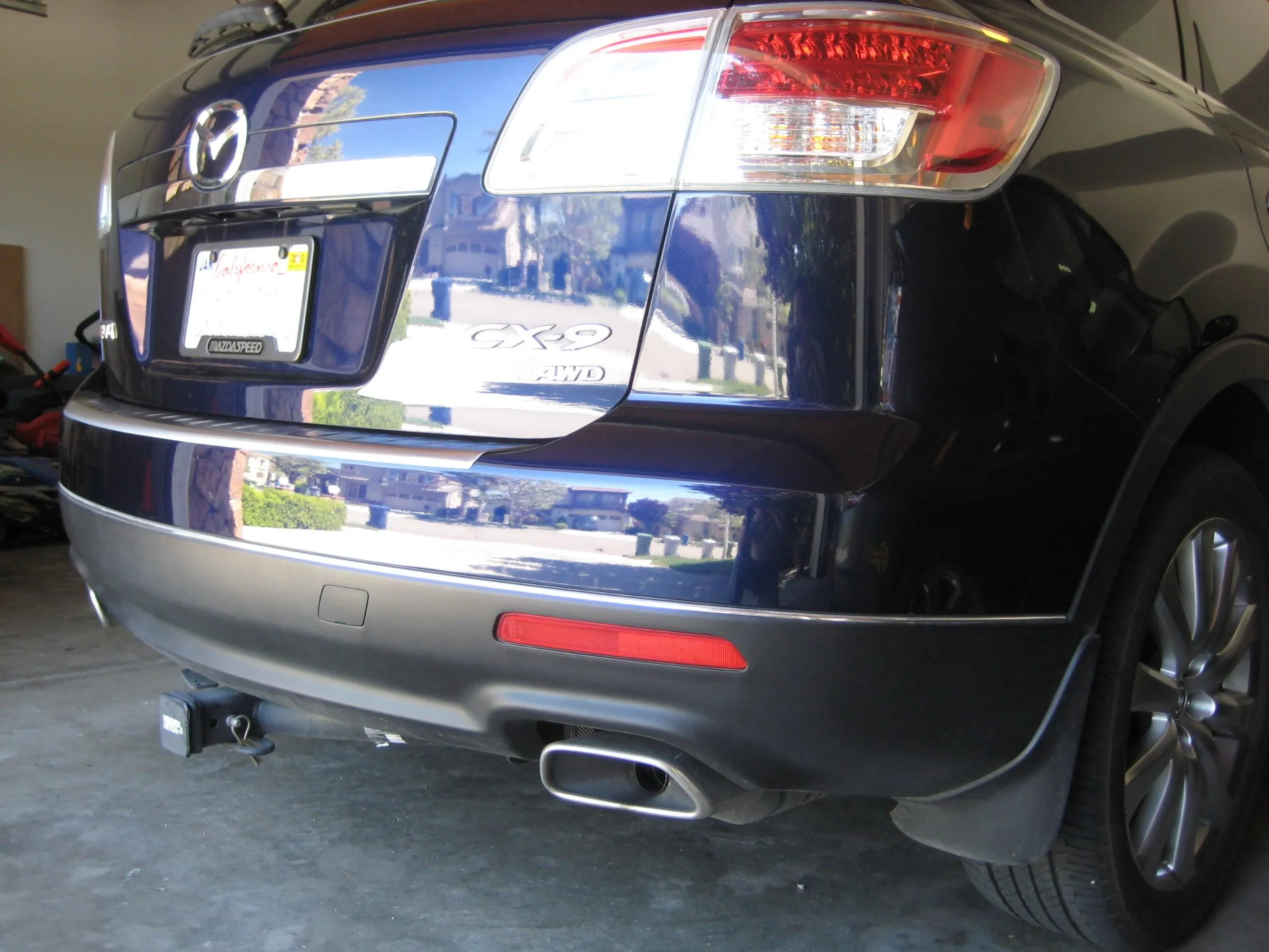

As an aftermarket hitch, this is as "hidden" as it could possibly be w/o cutting the bumper....
Maybe its the angle of the pic but it looks like it projects out nearly to the back of the bumper. I wonder if that is truly necessary. How is it from eye level?
bought a curt on amazon...and wiring from curt web site///took about 30 min to install..longer to tighten bollts than yo put hitch on
