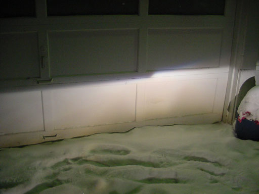

So now, the last thing. Most of you will now go "but my beam pattern is fine!" That's good for you. One thing that you can't see is the light distribution in various areas of the beam pattern's light field. For one thing, because of the increased light flux of the HID light, the hotspot intensity has been exponentially increased and therefore the halogen's light housing does not have the ability to control that (redirect) light to safe levels. Other typical places where excessive or insufficient light has appeared is usually at the far left of the light (in the negative quadrant) and at an area at the lower part of the positive quadrant. So wtf does that have to do with pissing people off? Increasing the hotspot also means increasing the glare because the hotspot is where most of the "stray light" comes from. So why is there a hotspot anyway and why didn't they take that s*** out to begin with? Simply not possible because the hotspot is also where the most light is (the light bulb), and also because of the fact that without it, you cannot light up overhead roadsigns effectively. Now as for the light in other areas of the beam pattern, you will either not see as effectively in those areas, or you will have lighting way over the legal limit (limits which were put in place to prevent glare "coming from the corner" and going to someone's mirror).
This is recent, done on a 02 protege ES with HB2 housings:
http://www.msprotege.com/forum/attachment.php?attachmentid=6282
notice that the beam pattern has changed and you can tell already that the increased light flux at the hot spot is causing excessive glare just from the light above the cutoff alone. Notice the major reduction in light at the far edges of the beam pattern. Also notice the reduced amount of light at the very bottom of the wall (if this was shining on the road, it would be reduced light CLOSE to the car). That's it for basic analysis.

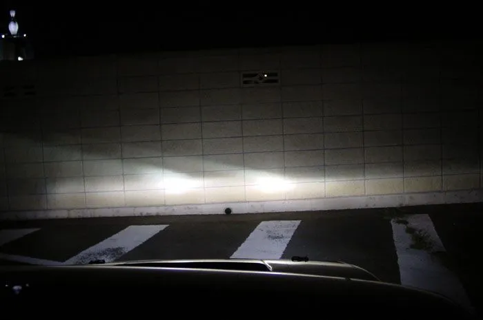

and for the non-believers of why j-spec headlights shouldn't be used and think all headlights emit a symetrical "blob" of light:
(see attachment)
picture from PS13 Silvia with reflector type housing with HID "retrofit"

The OEM H4 headlights like the one's on the MSP and Protege Sedan have a nice cut off. The H7 headlights of the Protege5 don't, it's two blobs of light - which is actually quite bright compared to other headlights. When I had my P5, I would get highbeamed every once in a while, using just the stock H7 bulbs! But I like the strong cut off on the H4 better.
I really wonder if there is a cap reflector thing (the thing that comes out in front of the bulb) that I can swap for mine. I really want a sharper cutoff. I do love the P5 light output though.

Yes you are rite there is a sharp cut off on the h4 protege head lights. Call me krazy but it is a very sharp cut off for a reflector housing. It resembles that of a Celica projector. I noticed this when I first bought my 03' 4dr protege. Does this make HID retrofitting legal? No. But I already ordered my kit and I just found this thread. I will install them and see how it works out and let you guys know. And one more thing, my friend and I both bought some cheap xenon bulbs. He had some in a h7 housing. And he said mine were brighter than his. Well that is because his housing scattered the light so much that it was not hitting the pavement. The 4dr protege's reflector is quite good. But it still does not make them legal. But heck I figure if a guy can put his truck six feet in the air and shine his lights down into my lap! Then they should not complain down here in Alabama, where those trucks are a dime a dozen. But that is how it is though. And oh yeah, very nice thread. This is much needed info for a lot of people. I wish I would have seen it before I made my order last week.
