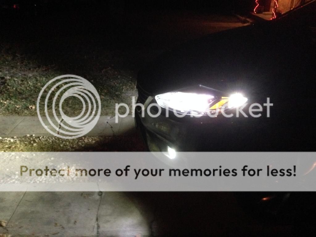

Example of 5k 194 bulbs in the side marker lights on my 14. Note: the photo show's a lot of glare, but that's just the camera. They look more subtle in person.

Hey metsfan999. I'm using a slightly older version of these: http://www.vleds.com/shop-bulb-numbers/194-168-158-led/6-5k.html Looks like they are backordered right now, which is unfortunate. I had them all over my old 6, as it used quite a few 194 bulbs. You may be able to find another source for a color match, but I've had great luck with VLEDs. Superbright's prices are comparable, and a bigger selection by far, however they only say "cool white" and "white". No telling if "white" is 5k or not until you get the bulb.
As far as the fogs, they are 5k LED H11 bulbs. (Got them on clearance from VLEDs, no longer listed as they went to a new product "LMZ") Went with LED because I kept the stock housing, where HID would just glare. It's not as bright as I was expecting for a 3000lm bulb in there (but the bulb is insanely bright, I know outside the housing). I think it stems from the reflector in there for the standard halogen bulb... The LED bulb has two radially firing bulbs, so front end glare wouldn't be an issue, but apparently taking out the reflector is a b****. Coincidentally, Mazda 2 foglights you can get on eBay don't have the reflector and are the same otherwise...
