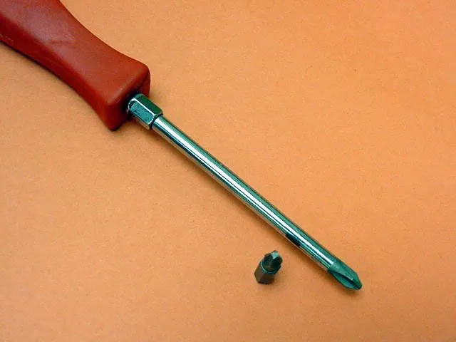

Here's how you take it off (make sure to wear safety goggles):

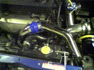

Well i got it all installed yesterday. I was pretty easy, but after i took it out i blew one hose off. Then i tightend them and went out again, and blew the hose thats behind my bumper that connects in front of the radiator. The problem is there is a 3.5in gap between the pipes, and i'm supposed to use a 4in hose. It won't hold since i dont have enough to clamp on. So i will be getting another longer hose from somewhere. So i havent been able to enjoy it yet. Here are some pics, sorry that they are crappy. I used my phone.
