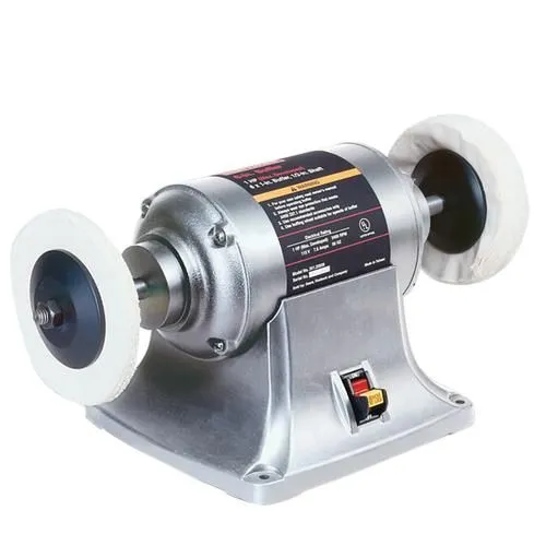

i tried to do that heat shield thing today, couldnt get it chrome shiny like that, mine just looks like brushd aluminum ahha, still looks better though.
Did you use a griding wheel or drill bit? You have to put some pressure on it. You buff off quite a bit. Just keep going.....and use buffing compound.
im not really sure what a grinding wheel is, i used a dremel for polish and 2000 grit sand paper to get off the brown

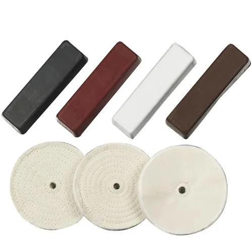

OH.......you need much more than that. Do not scratch it with sandpaper. A grinding wheel is like a motor with axels on each end. I call it this.....but I think it is called a bench grinder. See attached picture for a bench grinder with buffing wheels on them. Get dense buffing wheels. This is all you need. It does not sand or scratch it. You can get buffing compound in like a bar that looks like a large bar of soap. After you buff the heatsheild, press compond on the wheel and buff again. Hope this helps.
Buffing wheels and compound kit as found in Sears. (Craftsman). This is all you need if you have a bench grinder.
