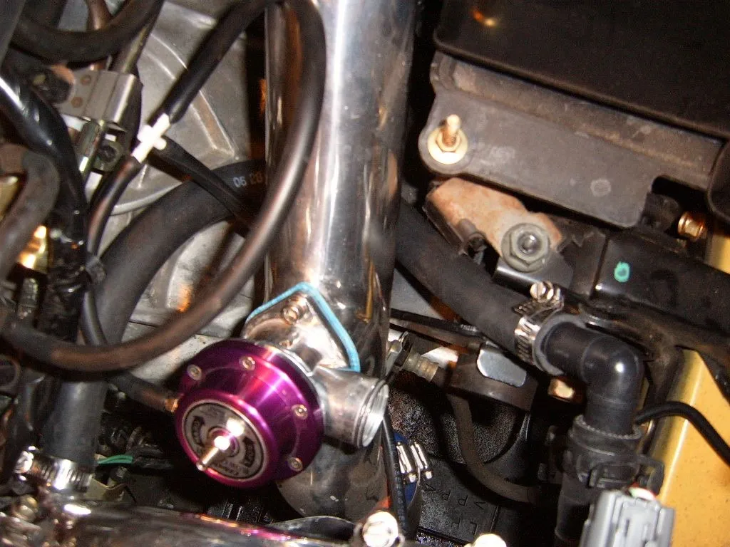

tighten the greddy type-s. for best results take it 3/4 tighter. I am guessing the bpv is slightly hidden? Can you take a pic of the bpv?
It's the 3rd pic in post #60

It's 2 am. After connecting the bpv vac to the bb line, the car is stalling less (probably due to the fact that I tightend my bov) but is still stalling. I forgot to post earlier, i've noticed that my exhaust is no backfiring too.
I sitill have all the stock hoses an vac nipple connected to the bpv. I'm going to replace all of them tomorrow and see what happens.
Could it be?:
My bpv is bad?
My MAF is bad?
I'm running out of ideas here. (confused)
Edit* I'm going to take more deatailed photos and post them 2morrow, hopefully.

It seems as if its not even recirc. hardly if any boost (dunno) . I might try a different bpv i have laying around.

Good idear. You could also just cap the hose to the BPV and do JUST BOV like ca_deal1 has said. Just to debugg the problem. I have even capped my type-S before to see if my BPV was faulty. I got the Boost Sciences BPV to replace the Denso.... much more responsive and rebuildable. Talk to 505zoom to purchase one.

ChiMSP said:
How did you cap the greddy?
Well I have the 19mm attachment for it. Then I got a short piece of hearter hose (19mm) and a cap for the heater hose (both at Auto Zone).
Lowes has larger hose that might fit over the BOV mouth (1.25" ?). Look around a hardware store, you will find some sort of cap to use.
Actually just take the vac source off it and put the screw all the way down. Shove something in the vac hose to cap it off. That might work.
