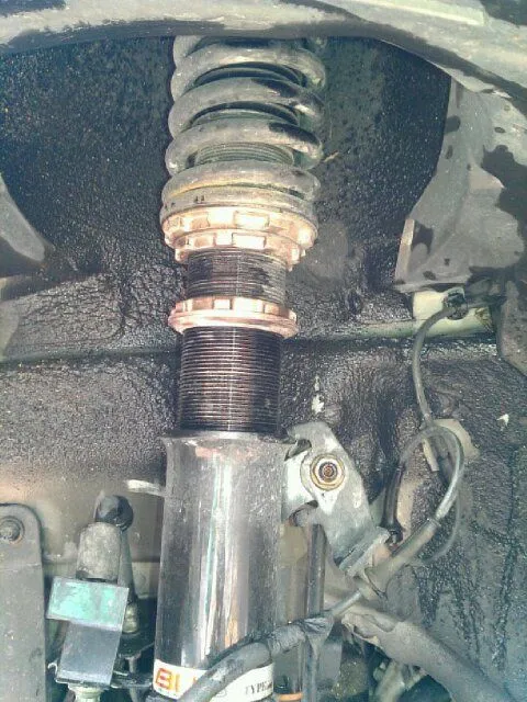

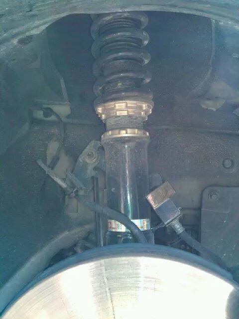

OK, if you have not done so recently, go outside now and check your ride height
I was convinvicened I had a bad right rear spring
ACTUALLY
I had my left front strut walk itsellf out a 2 and a half inches
spring perch was tight, the locking collar for the ride hieght let go
NEEDS be TIGHT
struts all good
relocked dust covers, other maintennece, etc
flogging time

tidied up, and pics added
not the double nutted spring collars, it was the ride height that loosened
I'm checking them tomorrow then, I'm all underneath the car to get her ready for a long Xmas drive...may be the cause of the suspension noise I'm hearing, I hope!
little update on this, I, with the ride height tight, I now hear little dunk, dunk, dunks while parking.
I think the last alignment, which involved a camber change, got the pillow bound up leaving the ride height as the easy place to rotate
and very slowly walked it out

figured Id try the easy way first. poured a bit of 50 weight harley oil on the pillow ball
no more spring clunk
hope thats the end of that little issue
